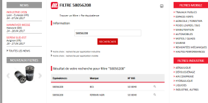

Hi there,
i have the bcs 740 , and i just find an alternative oil filter,
you can order this one :
Find filter by cross reference
reference : 58056208 BCS SO 8040
the new reference is 58056208
