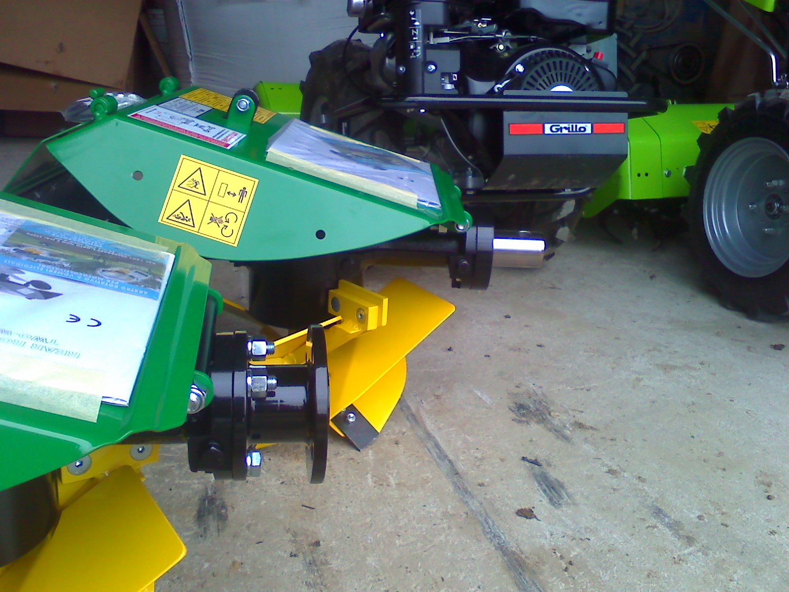

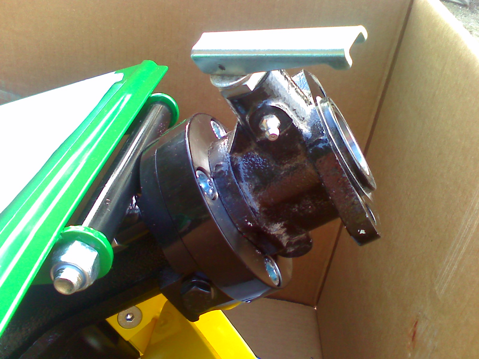

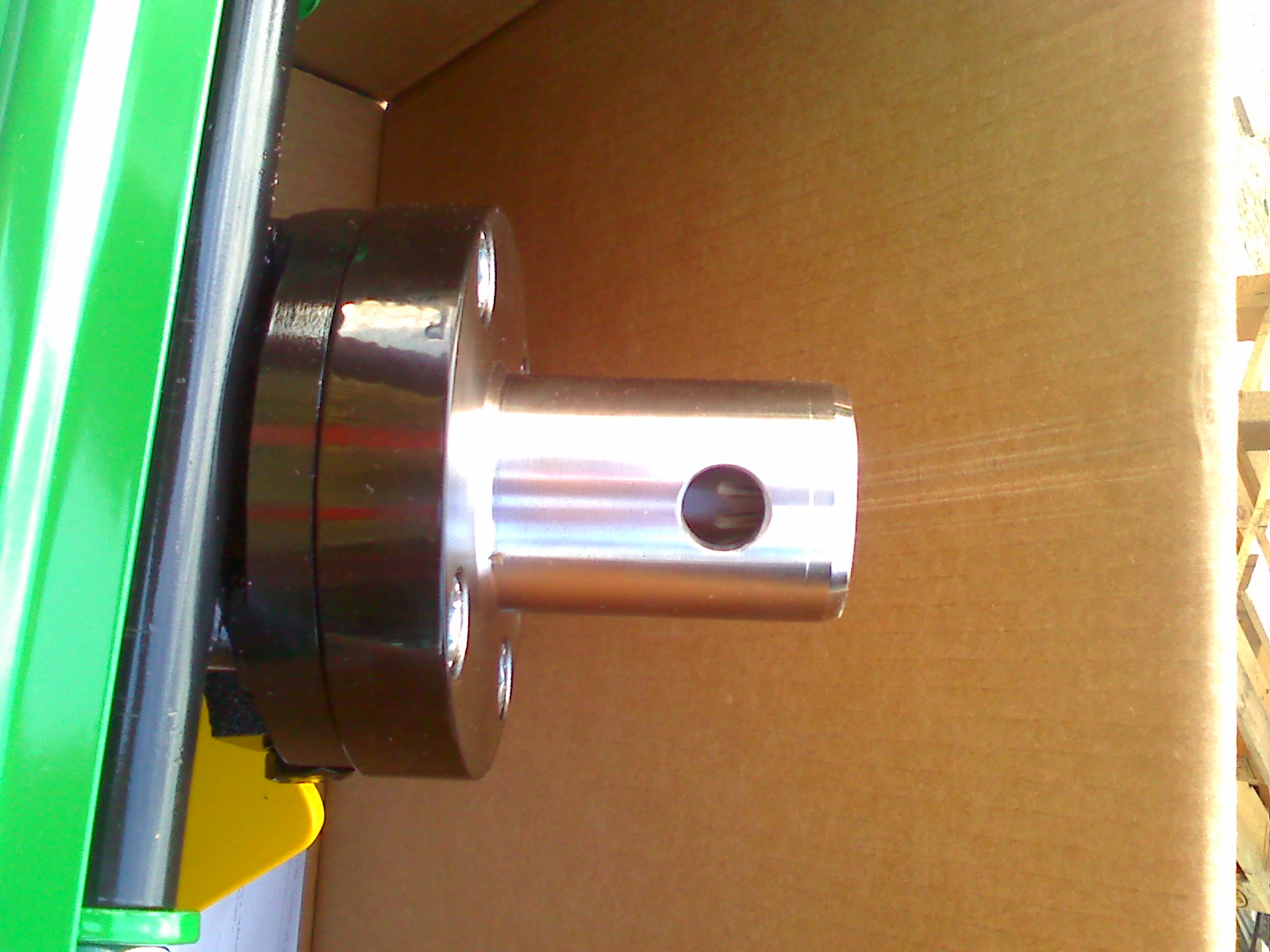

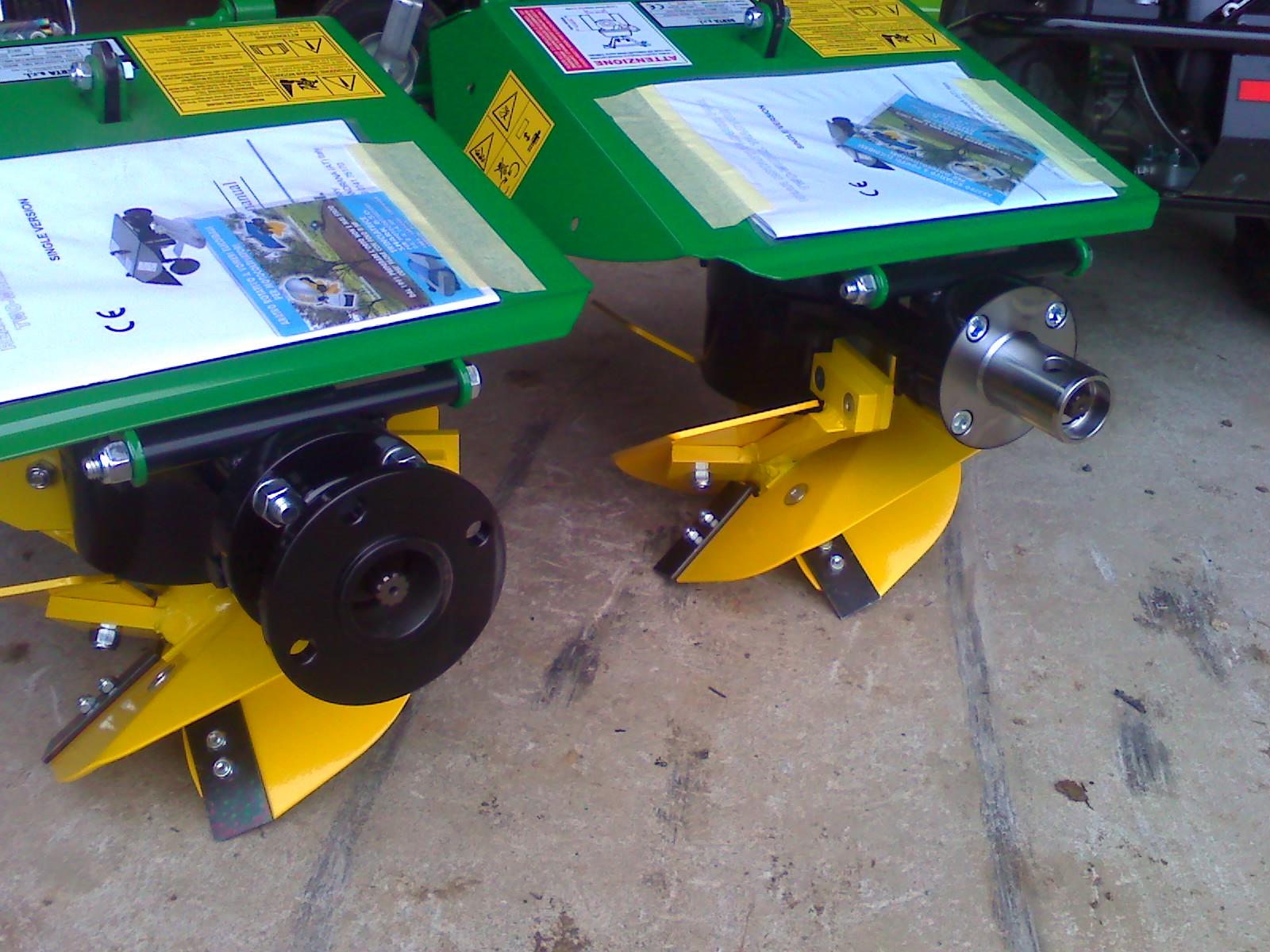

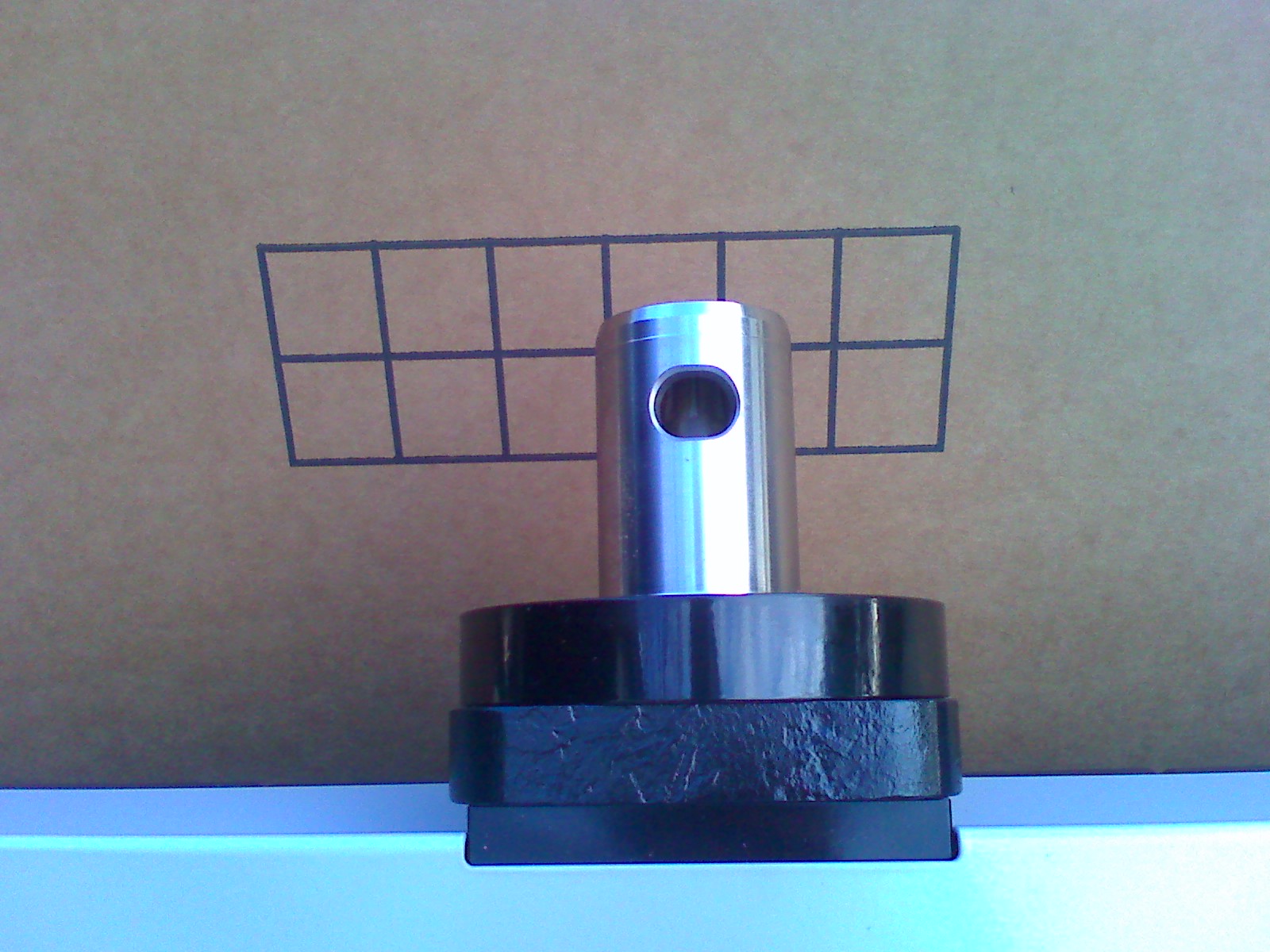

Unfortunately, I sold my last bolt-on rotary plow on Wednesday, so I could not do a side-by-side picture to show you that quick couplers are an option. The one I sold last week was brand new, fresh from Berta in Italy, not one that was left over from last year. I should be getting another bolt-on style plow late next week and will post a pic as soon as I get it.
The first and last pics I uploaded show a brand new Berta flail mower with integral quick coupler. As you can see, they slightly rounded the hole to get a couple degree's of tilt when going over rough terrain. The second and third pic show the rotary plow with integral quick coupler. The coupler for the plow and the mower are the same, they just drilled the two holes opposite - the coupler can be flipped to suit the attachment. I REALLY wish I could have shown you the bolt-on style as well. As you can see, the coupler unbolts with four bolts. A bolt-on type coupler can then be mounted. They're an OPTION. If a customer wants the quick coupler integral, they can have it. If a customer has the concerns you stated, they can buy a bolt-on and then bolt on the coupler.
If you'd like to measure if they got the hole positioned wrong, why don't you mount one to a tractor, then mount a bolt-on one to a tractor and compare the degree of tilt on the plows.
If BCS America got only quick coupler plows, they ordered them that way. If Berta got the coupler wrong as you stated, BCS America can buy just the attachment point and change them all out. BCS's quick coupler is kinda hard to duplicate because they put the shoulder in them. This supposedly is to make them easier to align, but I disagree. It makes them more likely to wedge when grit gets in there. The Grillo coupler is much simpler to make.

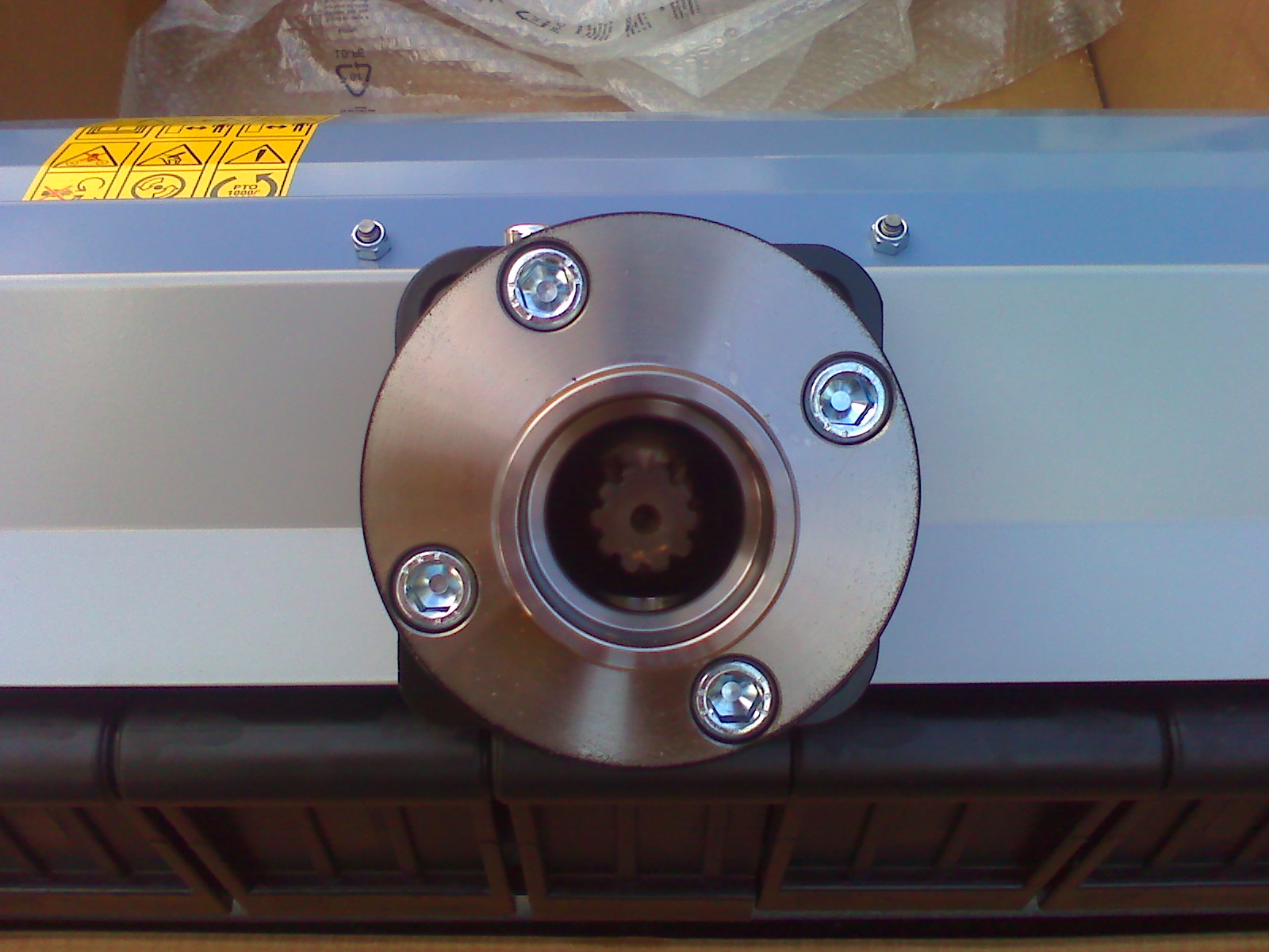

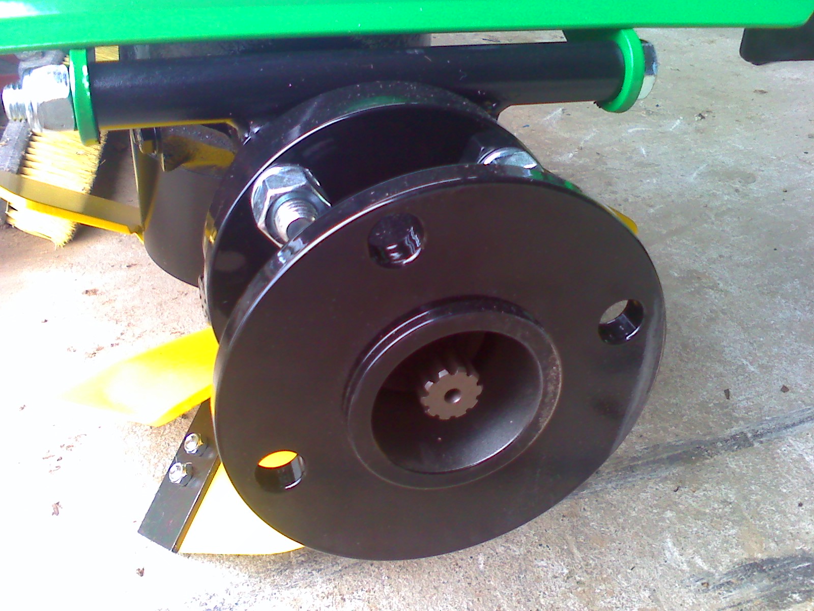

Hi John,
As promised, pics of the rotary plows with both the bolt-on flange and the quick coupler flange. If BCS America or one of their dealers hate the quick coupler flange, they can order the bolt-on flange.

Bill,
Thank you for posting the pictures of the Grillo version of Berta rotary plow with the bolt coupling and the 18mm PTO shaft Grillo dedicated quick hitch tang. It makes my point exactly. If something damages the Grillo dedicated tang on their Berta rotary plow you cannot change it over the standard tang and continue plowing. You have to get a replacement. Since you bought the quick hitch system for easy interchangeability you want common parts not special parts dedicated to one device. It seems Henry Ford taught us about interchangeable parts about 100 years ago.

Hi John,
I disagree that my photos make your point exactly. They show that the customer has an option to go with a bolt-on flange or a quick coupler flange.
The quick coupler flange offers many advantages you seem to have missed.
1. Cost. An attachment with quick coupler flange is $25 more than one with bolt-on flange. If a customer wants to buy the quick couplers for his machines, it is a $35 savings.
2. Positioning. The quick coupler flange is closer to the transmission versus a bolt-on flange with bolt-on quick coupler. This means the plow is a couple inches further from you. It also helps balance the relatively heavy plow to the engine, making it a lighter lift.
3. Strength. The more the bolts holding something together, the more places to loosen. an integral quick coupler eliminates two bolts to keep tight and a couple inches of length. Further, there is ONE LESS PTO part. Tangs are essentially PTO extensions. With a bolt-on tang, you have one more PTO shaft. I know of few if any situations where you would damage the bolt-on quick coupler to the point that it is unusable, but the attachment is undamaged. If something does happen and you have a Berta Flail mower, you can rob one off it. If not, a new flange is a couple days away.
You mentioned it being a "very loose and sloppy fit". .006 to .008 (by your measurements) does not fit that description. I do know that BCS quick couplers are so closely built that they can be a real pain to mount and dismount. Sure, they look and work great on a brand new machine and a clean socket, but get a couple hours use and gritty material in the connection and they become...difficult. They allow very little room to keep them lubricated. They could benefit from .006 to .008 of "slop". I deal with this often with my BCS 850 and various attachments. The longer the tang is used, the better it fits. Do you mean to say that I should be throwing them away and buying new ones as soon as they get "worn in"? Grillo has a grease zerk built right in to their female coupler. An owner can grease the pin, socket, and PTO without taking the attachment off. They're a much simpler, just as effective design.
