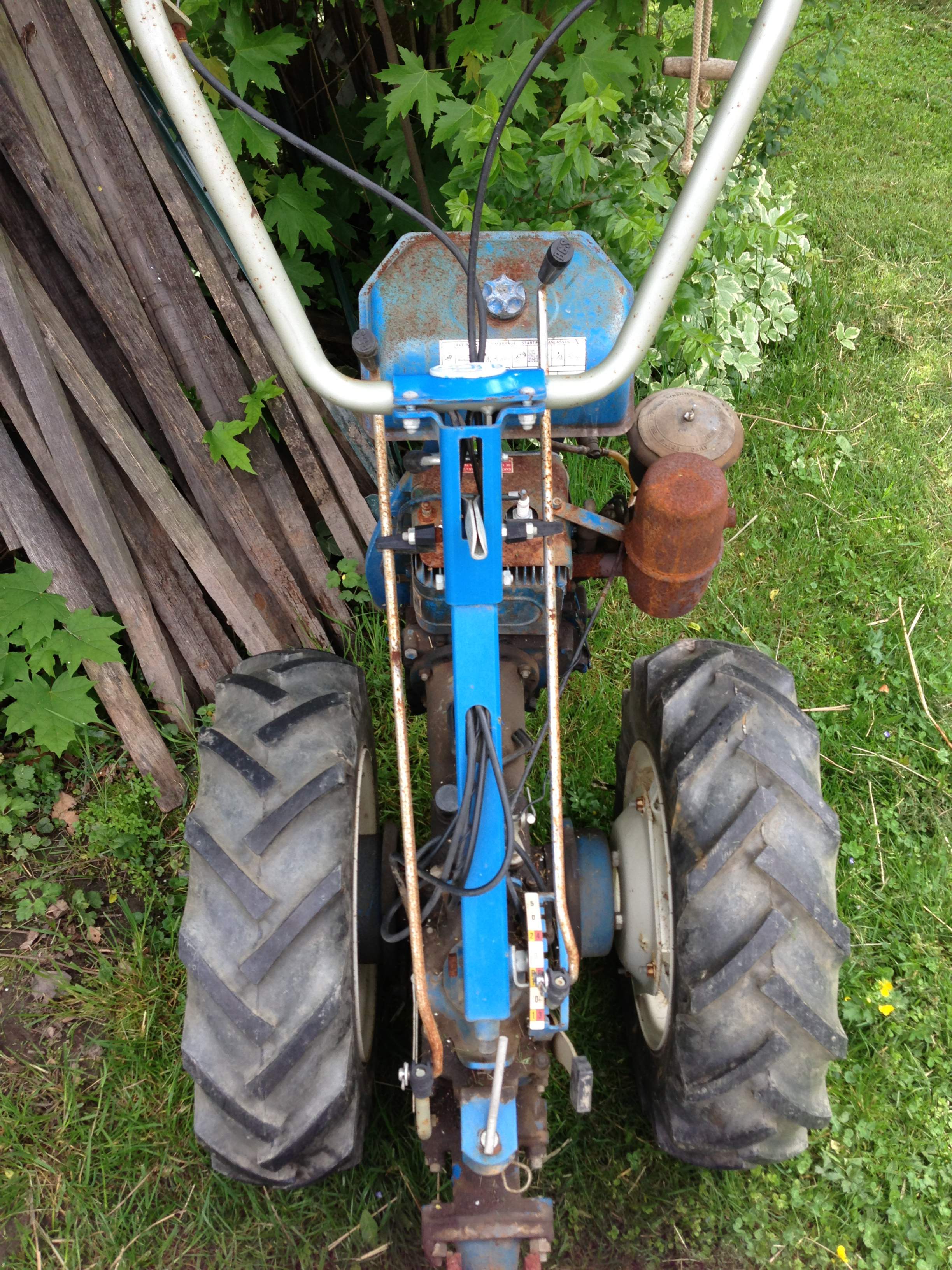

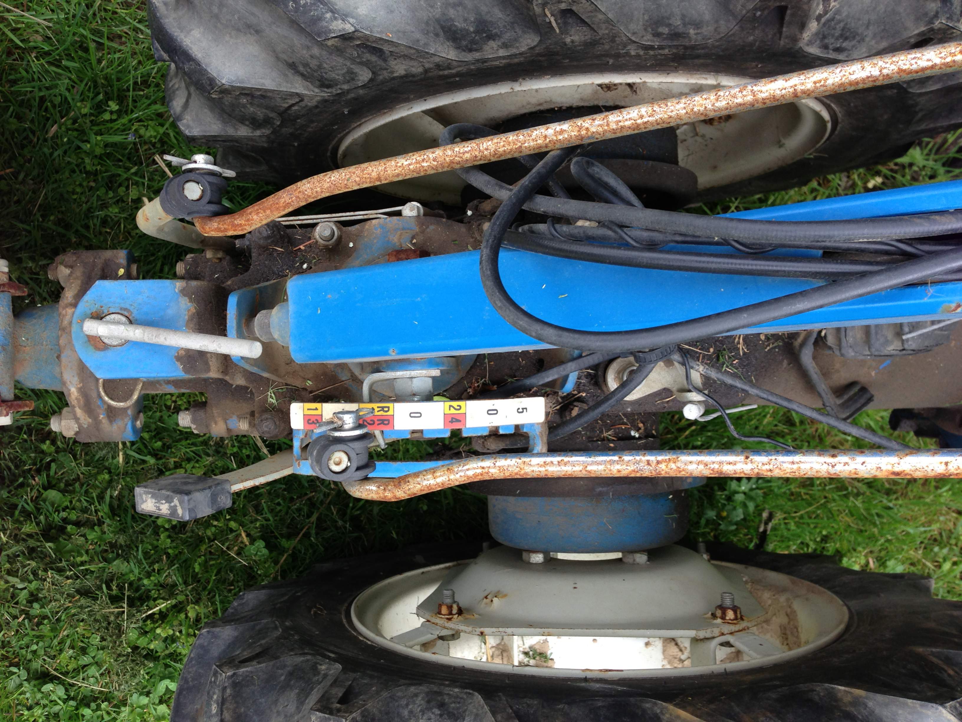

Anyone know much about BCS Tillers? I was given an older one with a 10 hp acme engine. I need help figuring out what model it is. Any help would be appreciated

The lawncare company I worked for years ago had a BCS tractor similar to yours but Im not sure of the model but I'm guessing that it is from the late 80's to early 90's. There should be a data plate somewhere on it that will identify the model of the tractor.
The one we had also had a 10 hp Acme motor on it and I was not found of it in any way. It was hard to start and hard to keep running. We called a local repair shop that used to be a BCS dealer but had since dropped the product line and parts for it were extremely high. This was also back way back when the internet didn't have all the sources that it does now. Long story short we replaced the 10 hp Acme with a 12 hp B/S motor and the thing worked fantastic ever since.

It has 5 speeds in tiller mode, 2 speeds in mower mode, differential with steering brakes, and splined PTO. It's a 735.
