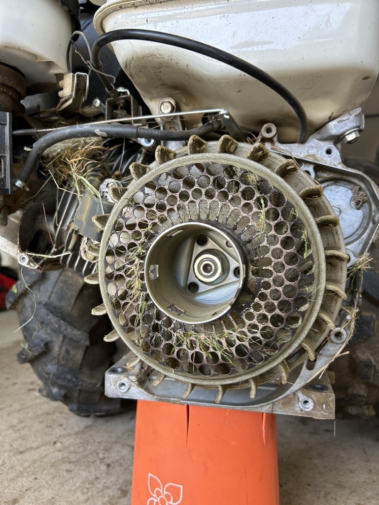

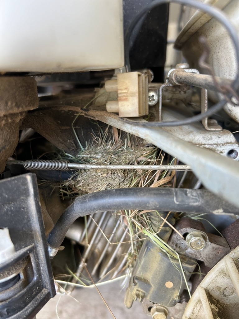

As I had the engine bumper and the starter off already, I also removed the fan cover and cleaned the cooling fins:
After seeing how much grass had accumulated, I will try to clean the fan and fins more often in the future.
