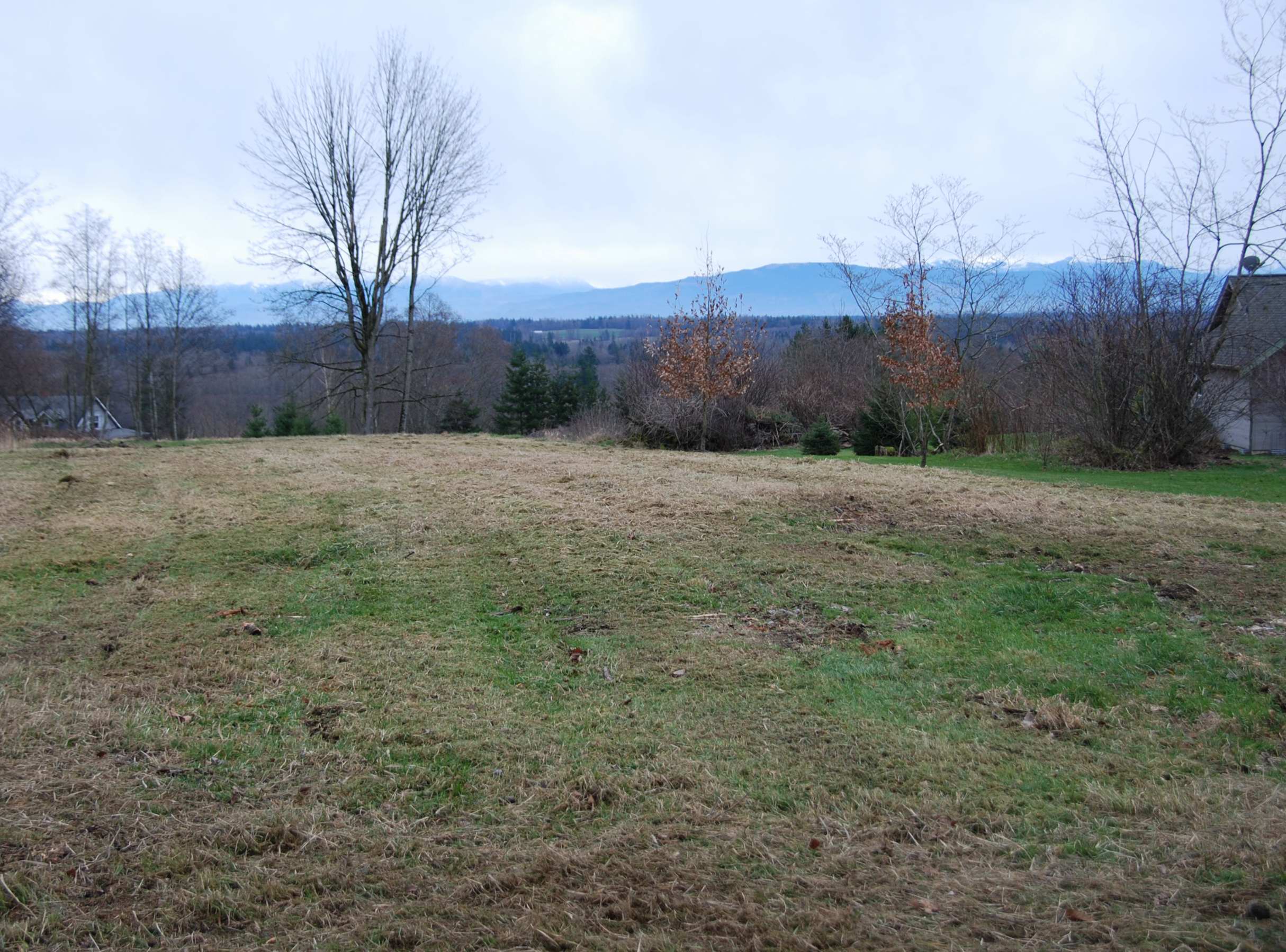

I am a first time flail mower user, and recently purchased a used BEFCO H80, which is a heavy duty flail mower. I have read all the previous post on TBN regarding flail mowers and for my situation it seemed like the right answer. I have a 3 acre field that I have been mowing with a Woods PRD7200 Finish Mower. It did a great job but did have some drawbacks. The field is not always smooth in all areas, I would mow once a month so the length would typically be around one foot tall. The finish mower did a great job, but did tend to leave rows of grass, and would tend to shoot rocks out the back from the many mole hills. The field is also on the edge of an Alder forest, which means lots of branches after a strong wind. The finish mower did not like branches and I found myself picking up anything over 3/4". The field would have soft spots in the Spring that the mower would tend to sink into, as it has all it's weight on 4 tires. On uneven ground it tended to hit high spots (they do make a roller for the front of the mower that would of helped, but I didn't have one). If I had a smooth yard, I would probably have stuck with the finish mower, because I already own it. The "Y" blades are a more heavy duty blade than the finish blades, so I can't equally compare finish quality on a lawn. After using the flail mower, for my situation, I would not go back to a finish mower. The flail does a nice job evenly/uniformly laying the cut material behind it, not in windrows. I can certainly cut up to 2" material with this flail without any issues. I like the fact that it has a 72" roller behind it so it tends to distribute the weight much better on soft ground. My flail weighs 1200lbs, so after working through a mole hill, it compresses the dirt back down. It's not as loud as the finish mower, and it leaves a nice cut (especially for a field). The added bonus is I can take it in the woods to manage brush.
As far as the BEFCO H80, it's their heavy duty model, and at 1200lbs, it is definitely heavy. It's rated for 40 - 80hp tractors. I have a New Holland T2320 (TC45DA) from a power standpoint no trouble running it, 3pt has no trouble picking it up, but you know it's back there. It has the "Y" blades which are very thick. Someone mentioned they are $6 - $7 each for blades, but I can't imagine replacing these very often. When comparing specs, I assume this is equivalent to a Alamo SHD72. If I was to buy one new, I would buy a medium duty unit (or even light duty if I was only cutting grass), again this thing is so massive, I don't think I will ever give it much of a challenge. It run's dual belts that are V-Groove belts and has a heavy duty belt tensioner. I got this used and it was a good deal, so bigger is better :)
I included some pictures. The field picture, I should have stopped and showed where I had already cut, but I was having too much fun. Most of the grass was ankle to knee high.

That looks great and you stole it!! I've been watching around here looking for one about that size or a little bigger. Looks like it did a great job.
