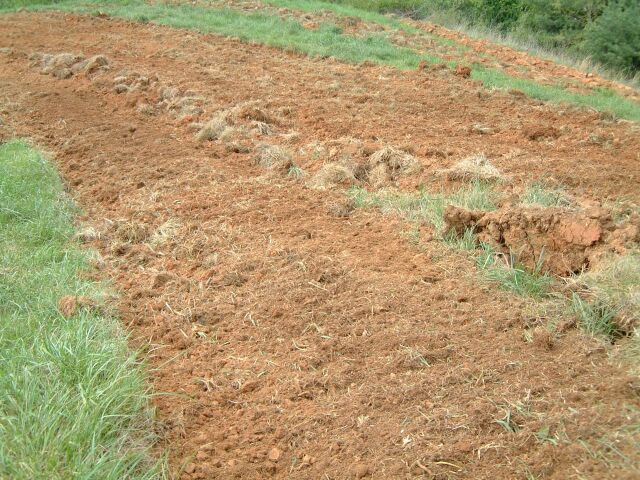

This field on a ridge on my farm has never had any crops on it in my lifetime (50 years), never been plowed, mostly red clay base with short grass, some blackberries, timothy hay, etc. I used KK 14 point double plow from TSC, then bought the KK 60" tiller. Took me two days to get tiller hooked up, lined up, greased, etc. I was amazed at what this machine did with this hard stuff.

yes i plowed too deep...and i paid for it when dropping wheels into that trench, too...angle meter on dash hovered around 15 to 20 degrees at times....spooky feeling. Never thought about turning over just plowing on level ground before.

another pic of field...will be planting pumpkins on this plot....supermarket, farmer's market, and setting a landscape trailer out in high traffic area for halloween. Got to do something to pay for this bota 4610.

after using KingKutter 60" roto-tiller. A digging machine. Can't even hear it running. and wow do I love hydrostatic now!

Although I'm not any veteran farmer with years of tractor experience, I'll try to answer questions just as I see it.
the hydrostatic difference......I just put mine in low range...step on front of pedal and go .....when it encounters rocks, or front of tiller digs down, or just extra thick turf and attempts to bog down or kill motor......i just simply lift foot.....engine catches up.....then i go again.........if i need for some reason to lift tiller and miss a spot...i can simply raise tiller.....step on back of bedal and reverse it......then back over where i missed and get tiller down and go again.......at end of row......when you want to come back down row or go to another part of field.......you just give it more gas......no gear changes........just makes things go smoother with one less thing to worry about
and. as for using it on unplowed ground......i'll send pics this evening to show you.......main difference is deeper tilling, more green manure mixed in, more mixing of soil.

I didn't even realize I had ROWS yet! I just plowed and cut up the soil and then tilled it. I'm not ready for planting yet. I will go back over.....there's 'no hill's'....it's just a very slight grade, almost level ridge top.....and the first plowing was ACROSS, not up and down
and as to why it took so long.....I had never operated this type of grease gun before....and had trouble figuring it out.......I could not get stablizer bars to let out far enough at first......I could'nt find 90W-140W oil for gear box anywhere in reasonable driving distance..every store here had 80W to 90W......one of my skid shoes was two notches lower than other one and the threads were stripped on the bolt holding in place.....and finally....i'm a rookie at this.......and it's kind of hard to hook up some of this stuff with just one person doing it.......hope that answered questions
