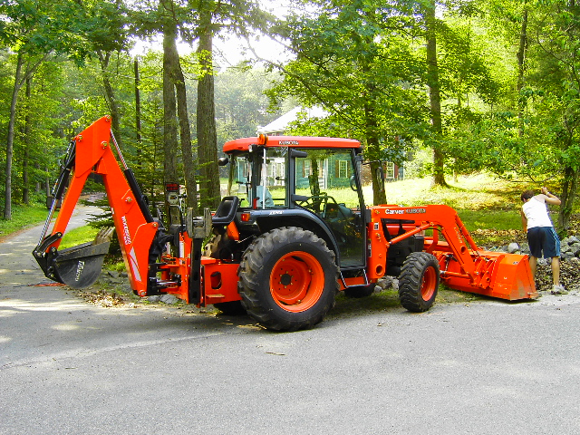

Hi Nathan:
I have been playing with tractors for only a few years. I really like my current set up. It's a 4wd Kubota L3130 with cab, weighted tires, HD loader and a Woods BH9000 backhoe. Everything is a 2005 model. Bought it new. Aside from my wife I love it most. Sometimes I love it better. OK, it's a bit more than you want to spend but you could buy used. There is a rule of thumb about HP per acre. With 31hp at the crankshaft it's got plenty of power. Still, I wouldn't want less. I have made retaining walls, put in 4500 sq feet of grass. This summer I will build a 100 ft rock retaining wall on my 5 acres. I also plow my long driveway in the winter. Funny thing: I am selling the backhoe attachment to buy a new one with a hydraulic thumb........which is the primary reason I am on line. You are probably too far away but if you decide you want a backhoe attachment, this one has only about 20 hrs on it. Not sure if I attached my picture correctly but here's my beaut. It's the most fun a guy can have.
