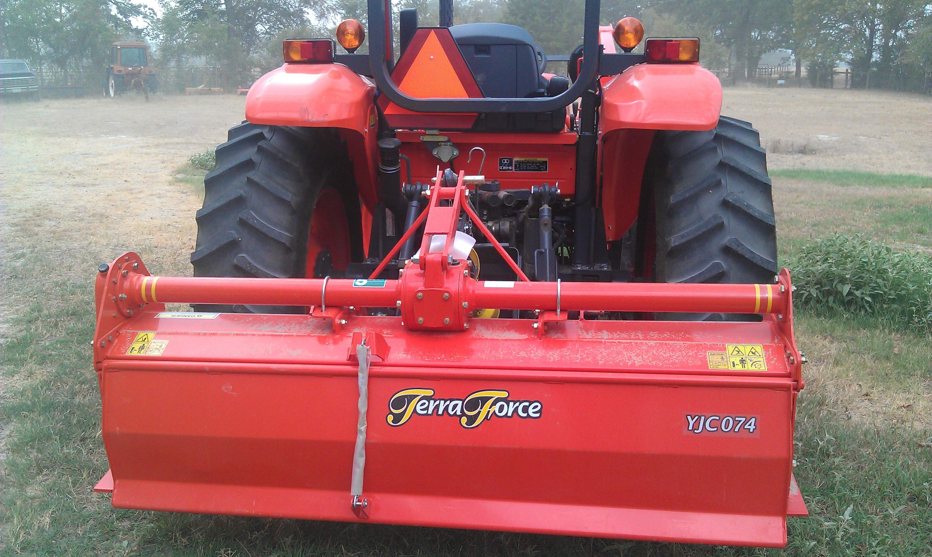

I had a 804 and just sold it but it was a tank. Shifter hard to find a gear(gotta turn knob this way or that way,never knew what gear was in),hyd.leaked down,brakes were always a problem but it sure would pull and the 3point power down would bend a bit before it stopped,there frontends on the 2wheel drive models are the weakest thing about them,mine was worn out with only 600hrs on tractor,tires turned all over the place but hey was my first tractor,better than nothing:D
