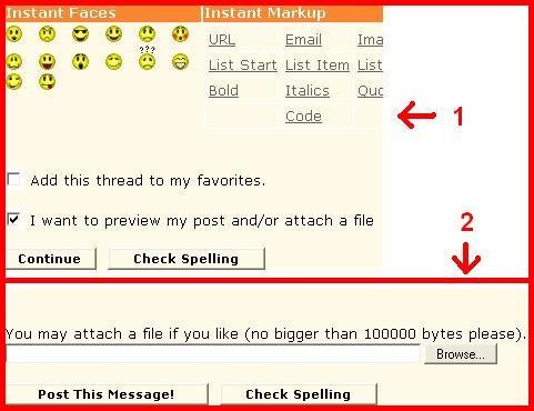

I did get pictures of my rig but haven't figured out how to attache them yet.

To attach a pic, reply to your post and be sure the preview post/attach file box is checked below where you type the text. Then just browse for the picture file. You may need to convert the pics to a jpeg format to get the file size down to a reasonable size (esp if they are currently saved as a bitmap image). To save as a jpeg, I usually just open my bitmap pic in Paint and then "save as" a jpg file type. It's pretty quick to do.

Make a reply to yourself in this thread, and enter some text. Make sure the check box in <font color="red"> 1 </font> is checked. Click the Continue button. You will now be previewing your message. Look for <font color="red"> 2 </font>. Press the Browse button to find the picture on your hard-drive. The picture MUST be in JPEG (.JPG) format, and must be smaller that 100000 bytes. Your picture won't show up in or on the message until after you click the Post This Message! button.
