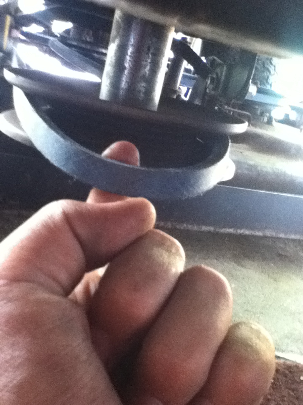

   / Belt size
This is how big it is when i gently pull on it

The belt i have now ses a95k/4l 970 k
   / Belt size #6
It looks to me like the belt you have now is too THIN. As well as too long. If in the picture, you are "just" taking the slop out but not yet moving the tensioner, depending on how much travel the tensioner has, I'd say the belt is every bit of 4-5" TOO long. Maybe more. AS well as being too thin.
