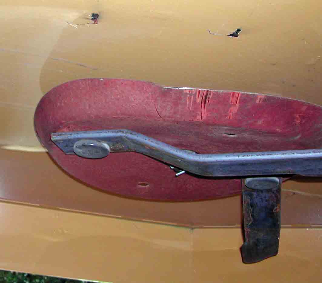

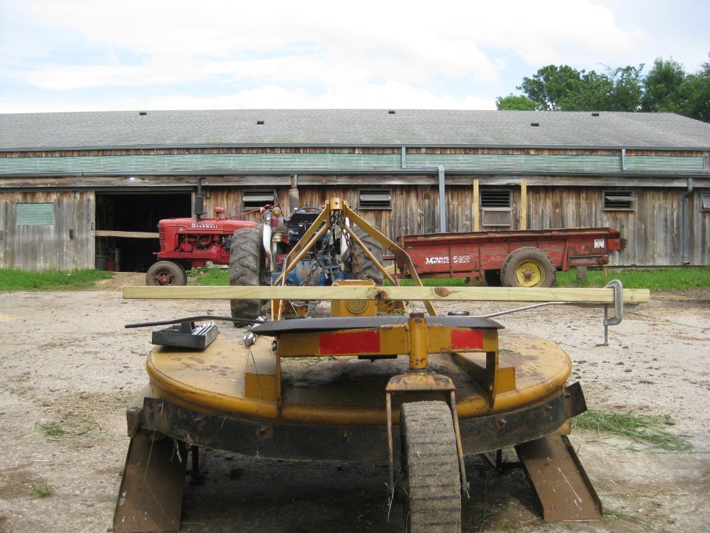

One of the guys hit a rock a few days ago and snapped the output shaft of our 60" woods mower. It looks like the rock jumper disc is also pretty banged up.
Anyone know what the blades alignment should look like?
I have attached a picture showing a 2x4 clamped to one blade. The cutting edge is not parallel to the surface of the disc. Should it be?
If I push the end of the board down to make it parallel to the disc, the other blade is still not looking good.

Yeah the blades should be parallel to the stump-jumper surface. They
are not expensive at all (AgriSupply), if they are severely bent. If
your stump-jumper is too distorted, you may want to replace that, too.

Thanks - I'll try some sledge hammer work and see if I can flatten the stump-jumper enough.

You might want to check on the price of the stump jumper. I replaced one on a Woods MD172 (model prior to the BB720) That was 7 years ago, but the stumpjumper was less than $150.
