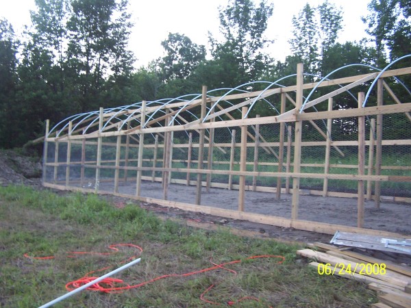

I am sure some body on this forum has bent so pipe for green house hoops
looks like you guys have done everything in the world else. I think the pipe my other hoops are made from a fence pipe for chain link. the guys I bought
the orginal hoops charged too much and I think I can get the job done with
http://www.hoopbenders.net/4999dyseriesbenders.html
Interested to hear if anybody else has done this?

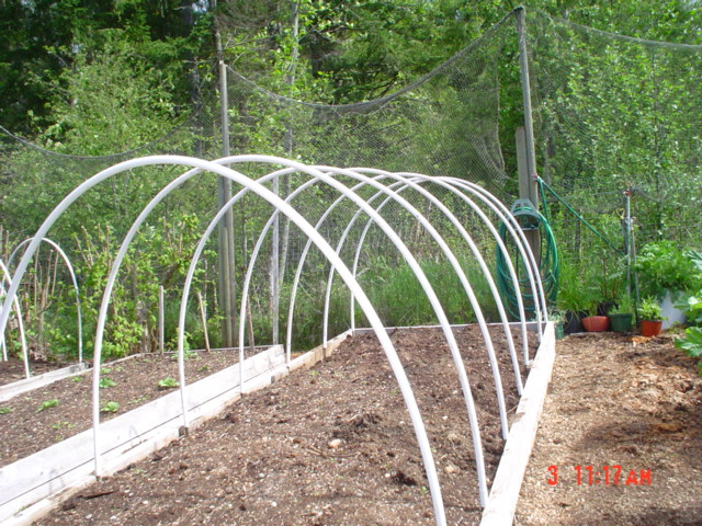

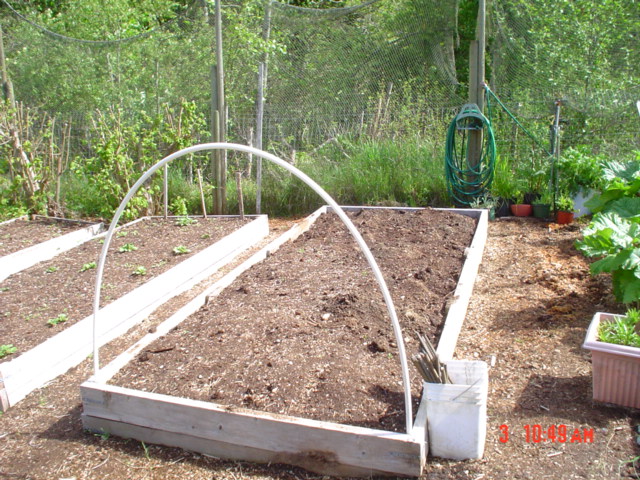

I used PVC pipe to make this small hoop "green house" for two beds. :)
On a larger structure you may need to go with steel.

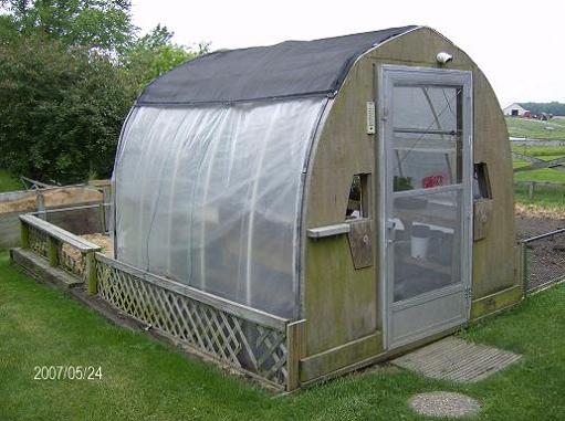

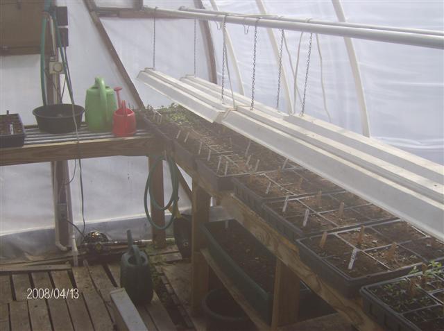

I used 1" PVC on my 10' x 10' greenhouse, has lasted for many years!
