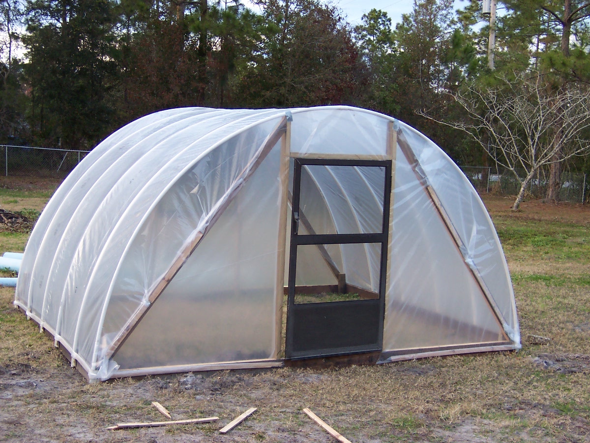

I made this house a few years ago using 3/4" PVC which bent easily and I fastened the ends to keep the shape.
I bought the good plastic to cover it.
Here in Florida if you do not go the extra step for climate control the house can be 35* in the morning and 150* by mid day!
If you goolge you will find plans and examples.
