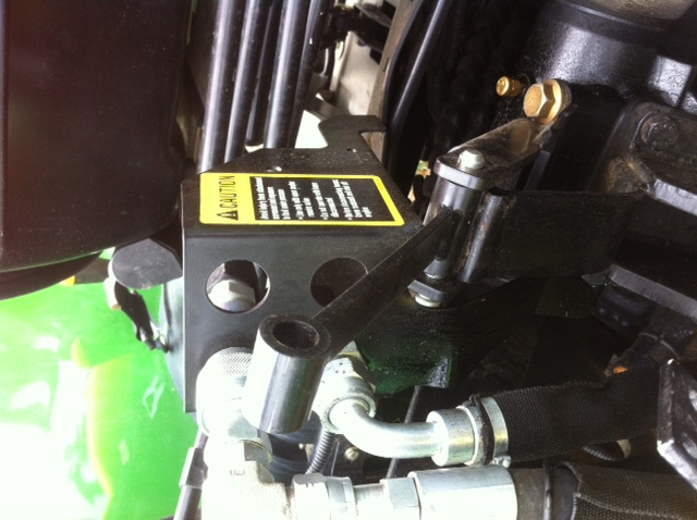

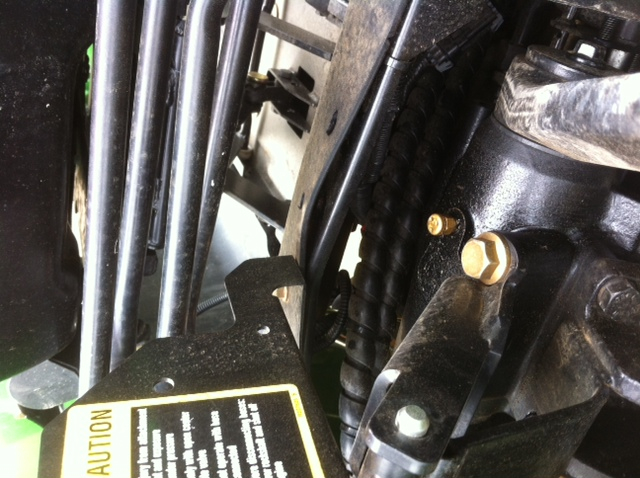

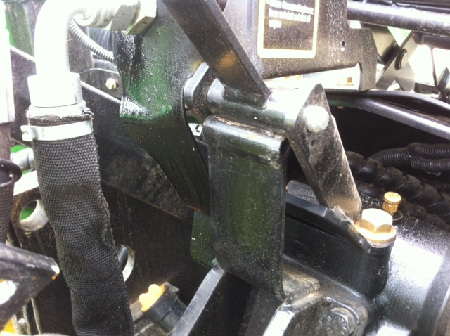

I'm new to tractors so I guess I'm going to make mistakes. I set my backhoe down and went to put on my quick hitch by myself. I wish I had asked for help because I ended bending part of my tractor.i hope this does not cost too much to fix.

Another pic

So the hoe was off and on your way to get the iMatch, this bending happened?
Or...happened before you un-hooked the backhoe?
Or.. after you put the iMatch (quick hitch) on?
Sorry to see any bending. From what I see, doesn't look serious, but nonetheless, also not pretty.
Is only one pic of the three right-side up? Two are 90 deg?

The backhoe was removed and I was hooking up the Imatch. I needed an extra set of hands to hold it up as I put the pins in. I hooked up the lower right pin and then held my upper top n tilt cylinder in place with one of the bent arms in the photo while hooking up the upper pin. I couldn't hook up the lower left pin so i raised the rock shaft arms but the upper cylinder was still hooked up to the arms in the photo. Those arms bent quick.

Gotcha. Bummer!!

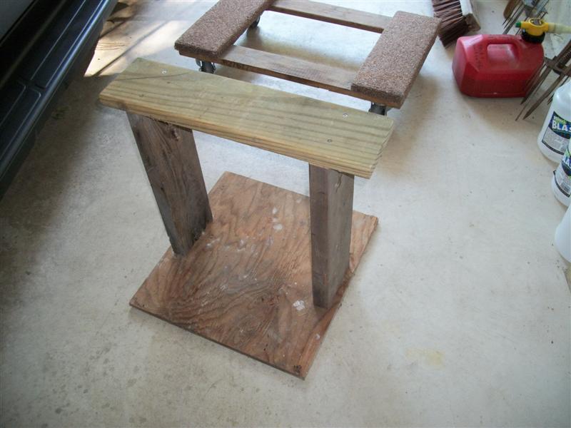

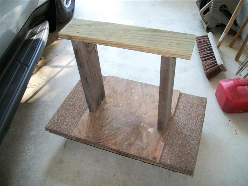

I made a jig to hold the iMatch. Set the jig on a 4 wheel dolly and lower the iMatch onto it. Then wheel it off for storage. It keeps the height right for easier hookup.
I know the feeling of needing three hands to hold it up and line up the holes for the pins.
If I remember I'll post a pic tomorrow. I think I patterned mine similar to someone else here on TBN.
What is the plan? to take off the bent parts and replace or try to straighten?
Sorry about the damage:(
What I do to hookup the IMatch is set it over the arms on both sides then raise one side (picking up on IMatch by hand) at a time to pin both lower pins. Then pin the top link cylinder in last. Reverse order to remove.

Here is the carrier that I threw together. I remove the iMatch hitch once or twice a year for my rototiller.
Much easier to set it down on this jig that sets on a 4 wheel dolly. No balancing act trying to line up the pins and ball-ends while holding the hitch up in the air.

get some wider shoots plz. the pictures are zoomed right down on things. but honestly have no idea were on tractor you are taking pictures of. i understand rear end of tractor. but that is about all.

I always leave my quick hitch on annother attachment when I take it off. then it is just like hooking up an attachment without a quick hitch to reattach the quick hitch.
   / Bent 3 point tractor hitch #10
Looks like one of those $15 furniture movers from Harbor Freight.
Good idea!! I just removed my QH today to install the chipper and I've been using a rope (clothes line) tied to the ROPS to support it, but that rig looks much easier to use.
