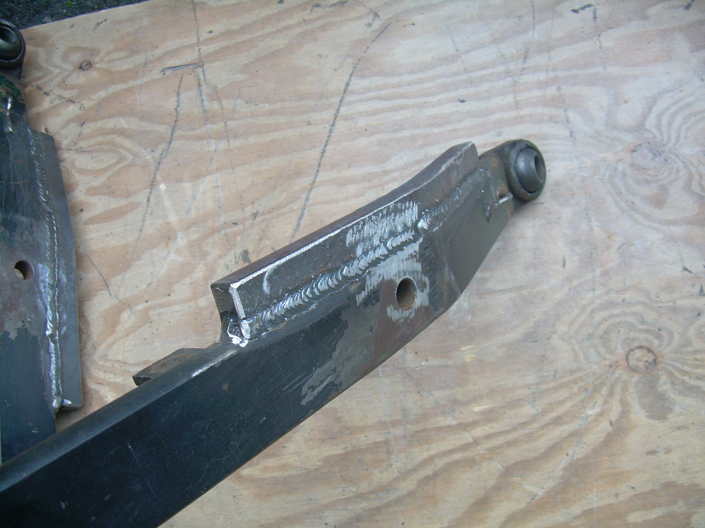

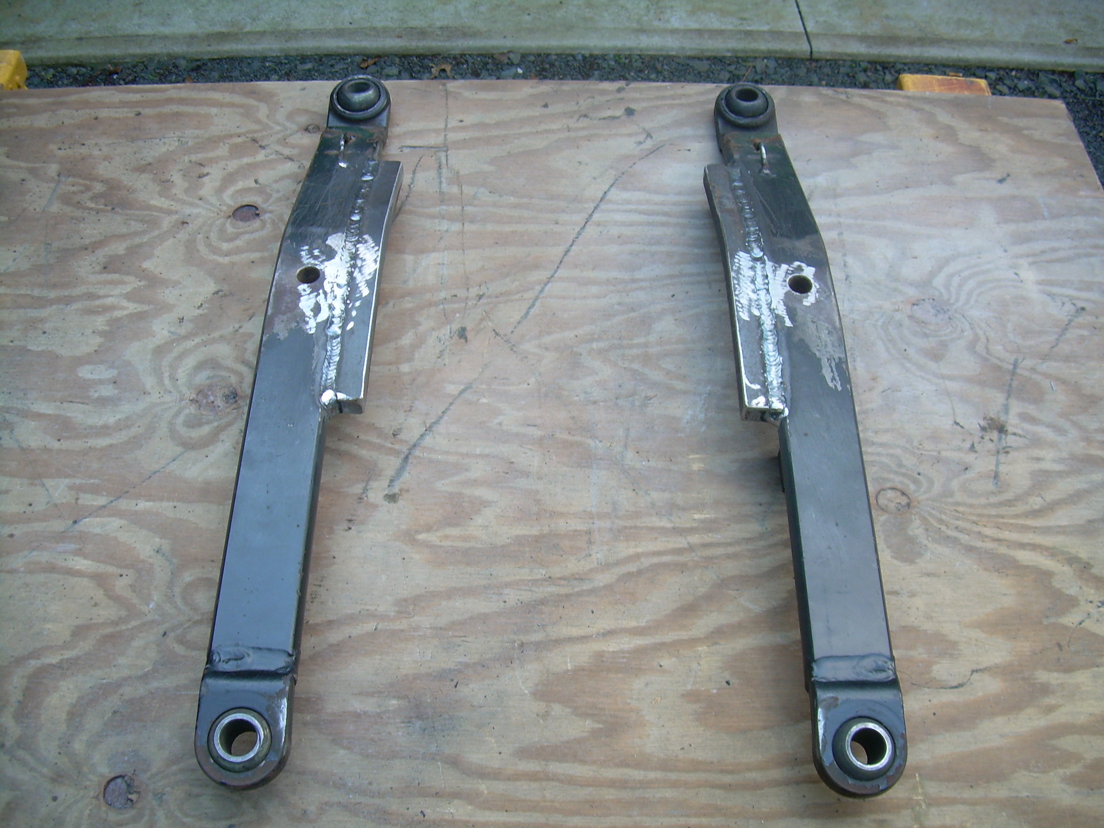

What ive had done is inch by 3/8 flat steel bent & welded along the bottom of the arms as a gussett, of course thats after straightening the bent arm in a press, it should now hold up but no doubt the steel used is not tempered at all just mild steel and id guess all made in china/india.

Yep aftermarket gear, what else would i expect..anyway here is a couple of pics..
3PL set up
This is the gussett i have had welded on and today i moved 25 bales with no issue
You can see what im talking about saying the std arms should be well and truly strong enough but they were not.

You wont have any more problems now with that repair.
Those arms look pretty wimpy. My JD's are beefier (32 hp) I still bent them, but I was hammering them into snowbanks in REVERSE with a rear blade :eek:
I repaired them with steel underneath, but for some clearance issue I couldn't extend them out wider than the arms like you did, (which makes them even stronger) I had to make them the same thickness, but I added about an extra inch to the bottom. and have had no more bending :)
