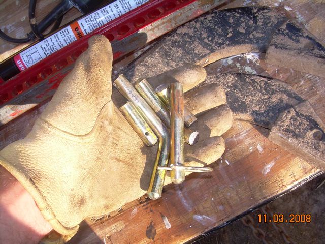

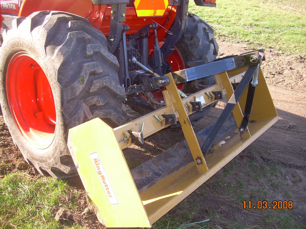

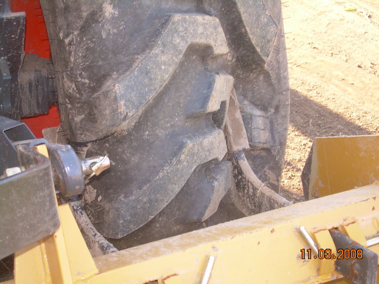

Mr. Murphy paid me a visit today :mad: and showed me why Kubota's top link is better...... the threaded end is captured so it won't FALL OUT if the retainer nut vibrates loose.
God was watching out for me, instead of two punctured tires I squeaked by with two cut pins. Whew!! (hey, maybe there's still hope for tomorrows election! :))
