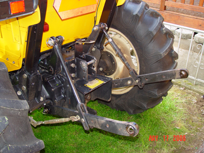

Bent my right lift arm today, Cub Part # MA-10373011AG0. $273 from Cub website? Can that be right?
I repaired a 1/2 mile dirt drive today with my 6.5' box blade. Guess I got a little rough with it. The BB ripped a rock about 5' long by 3' wide and 9" thick out of the ground. It actually stalled the tractor in low range, 2nd gear. I couldn't believe it when it brought it up out of the ground.
Anyone have a better idea where to purchase, or at least the specs on mine. The tractor is at the farm right now and I can't measure it. If you know the degrees of bend at the front and rear, the thickness and the dimension from front to rear and top to bottom, that would help.
I really like the setup on my friends Kubota 3010 with the extendable arms. If I'm replacing one, i'd rather upgrade to something better.
For $273, I may try to bend it back. It's just "tweaked" top to bottom like one side of the BB lifted way higher than the other side. The arm did not flex in the middle. I guess I could pin just the right side of the BB and use a high lift jack and possibly jack the left side of the BB up and maybe coax it back to straight. This may wind up just bending the pin on the BB though.
The attached picture is pre-bent.
Any other ideas?

If you Google Agri-Supply, they stock several versions, here's one example;
Center to Center: 32"
* End Holes: 7/8"
* Mounting Holes: 5/8"
* Thickness: 1/2"
* Width: 2-1/2"
$20.99
Maybe try TSC, Messicks or other web sources.

Thanks Curt, I'll try to get the measurments off the Cub this week. Didn't think about Agri-Supply. $20-$40 sounds a whole lot better than $273!!!
Not sure if I've seen any at my local TSC. I'll looke there also.

If you have one of the stores mentioned near you, bring your arm with you. They come off easily.
Mahindra is using Mitsubishi for its compacts, another option if there is a dealer nearby. Your best deal would most likely be the ag stores mentioned if they have the right one.

Thanks for all the ideas. I'll see if any of these pan out this weekend. I think I can still use it "tweaked" as it is, but it'll be a little harder to hook up the implements. I knew the members of this site would come through with lots of ideas.

I bought a pair at TSC for my Ford 1220, I think I paid around $35 each.
I also bought a three point setup on EBAY, lower links, sidelinks, toplink, antisway, the whole deal for about $100 + $25 shipping.
