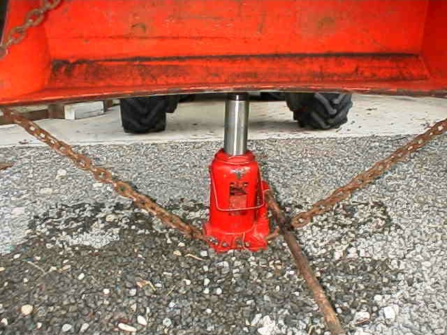

You can always strighten the bucket the old and easy way
I used a jack and a piece of chain.
See attachment
