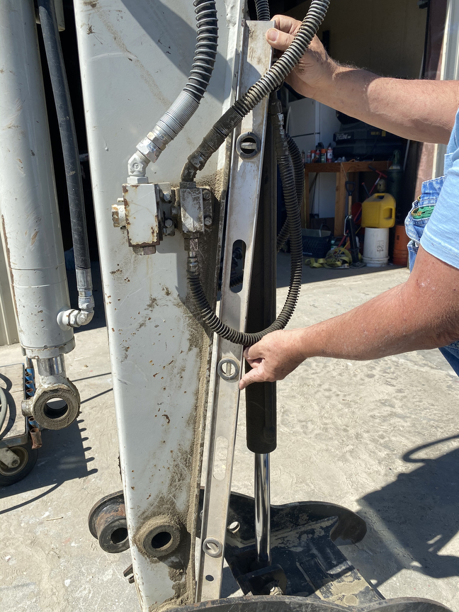

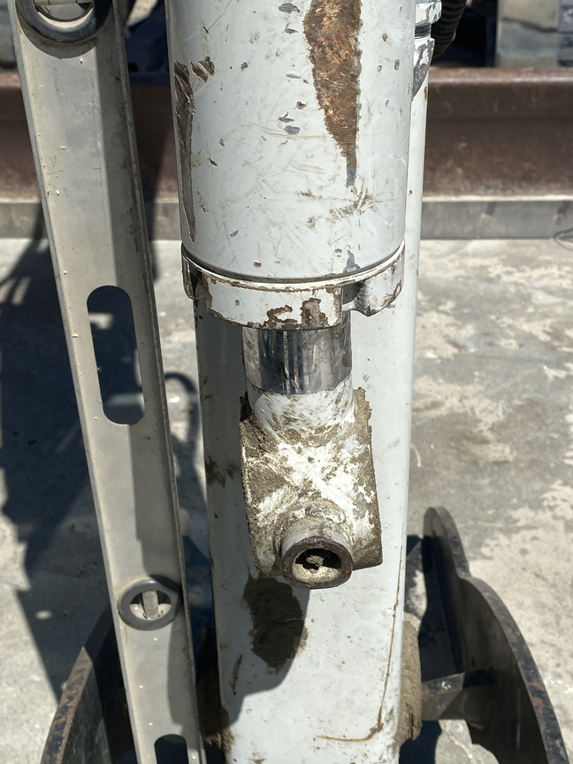

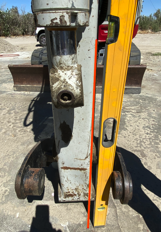

From what I understand trees are the death of excavators and now I know why.
I bent the tip of the dipper arm clearing some trees and brush. Apparently one of the trees snapped back and caused havoc to the Takeuchi TB260.
Bent the dinner arm, tore the couple like it was made out of tin foil, bent the end of the hydraulic upper shaft, and skewed the bucket guides.
$800 for the coupler, $3,000 plus for the dipper arm, don't have a price yet of the hydraulic shaft rebuild.
Live and learn. Just don't be me out there guys. This was one expensive education.

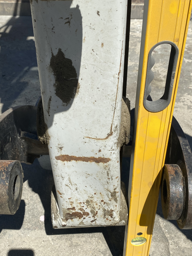

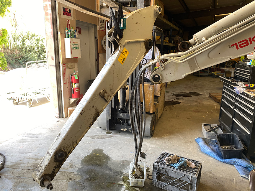

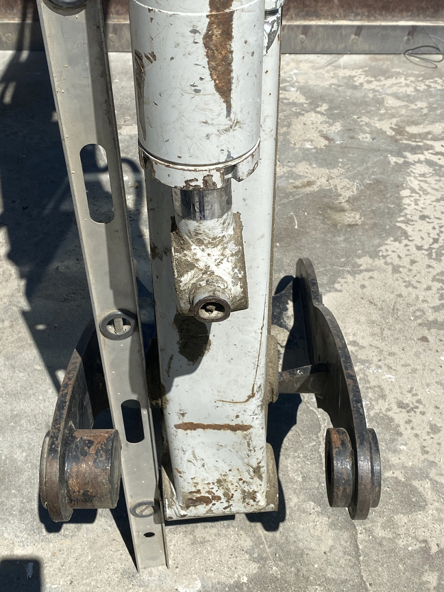

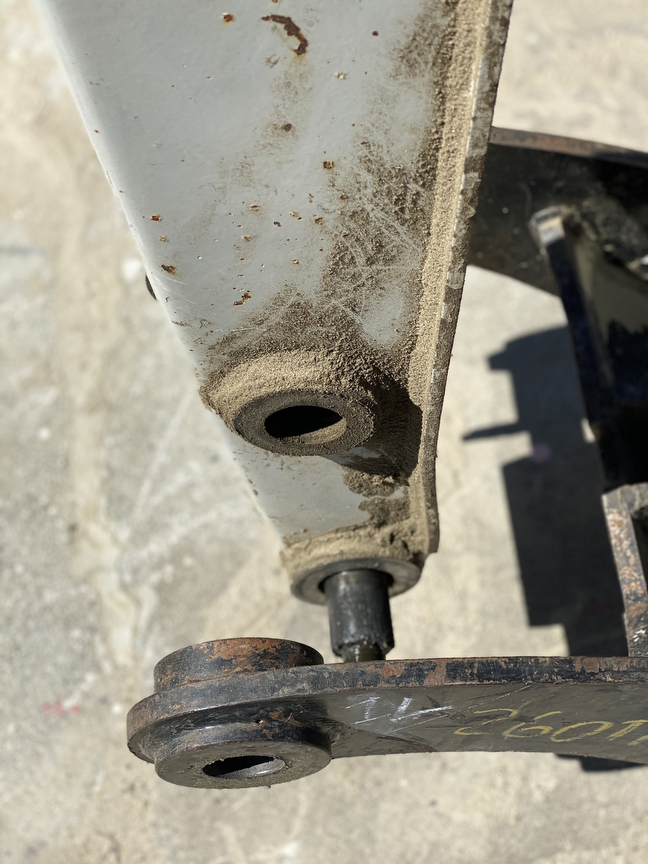

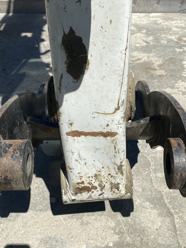

Boy, I'd love to blame this on someone else unfortunately it's all on me.
I truly can tell the exact time it happened. I remember grabbing a mesquite tree (they grow along the ground) so they aren't your typical "tree" more like large 24" tree roots along the ground.
These things have been tugging at me while I was working on these for days, tossing me around so this particular tree was no different than the rest. Having said that I sort of remember this on release and swing back at the excavator like a rubber band snapping back when you stretch it too far.
I didn't think much of it and brought up the bucket for the next grab at it when I saw the bucket dangling and holding on by a thread.
I got it back to the shop with the bucket swinging in the wind. Shut it down and called my welder telling him that it looks like I tore my bucket and it needs welding.
The next day I looked it over and it was the coupler that was torn and twisted ( I'll get a picture of it ). Then the more I looked and EVERYTHING was best out of shape including theIMG_2384.JPGIMG_2386.JPGUnknown.pngIMG_2373.JPGIMG_2376.JPGIMG_2375.JPGIMG_2374.JPG dipper arm.
   / Bent the dipper arm
Tore the steel like it was tin foil

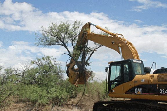

This has nothing to do with "common sense". I've been using common sense with equipment for 40 years. The issue was with this ONE TREE - period. Of the dozens of trees that I successfully removed using "common sense" This one bit me.
The Mesquite tree is a brittle dry tree in the desert that grows along the ground with large roots.
it's a hardwood great for grilling steaks as the wood burns a long time. You can either cut them away using up hundreds of chain saw blades, or bend them with equipment till they break, actually snap in half.
This one tree bent, and bent, and bent and then snapped back with an inexorable force enough to cause the damage.

Here's an example of the brush. Not like a typical tree we're all used to.
