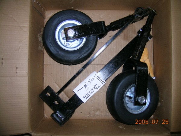

Thanks Junkman. I have a KK XB series landscape rake which I bought from TSC last year. They said the wheel kit would be available shortly. It wasn't & still isn't. I bought the gage wheel kit for the KK regular rake at TSC for $200, took it home and figured out a way to adapt it to the XB with a bit of drilling and welding. In re-thinking this project, I'm not happy about spending $200, which I think is way overpriced, and then having to make modifications on it. KK says the gage wheels for the XB will be out when the '06 product line is released in Sept. so I'm going to return the wheels and wait til Sept. If they are not out by then, which wouldn't surprise me as KK has told me on a couple of different calls that they will be on the market in a couple of weeks, and that was months ago. Worst case, I'll have to re-purchase the regular wheel kit and start over, or make one myself. Thanks for the offer but I still want to get a welding set-up for myself. They are handy to have around, and now I have an excuse to get another tool. /forums/images/graemlins/laugh.gif
Does the attached pic look like it should cost $200?

I picked up a set on ebay awhile back for $30. I needed to put tubes in the tires for $4.95 a piece. Other than that they were just fine.
You could also build them for a lot less than that. That was my plan until I came across the ones on ebay.
