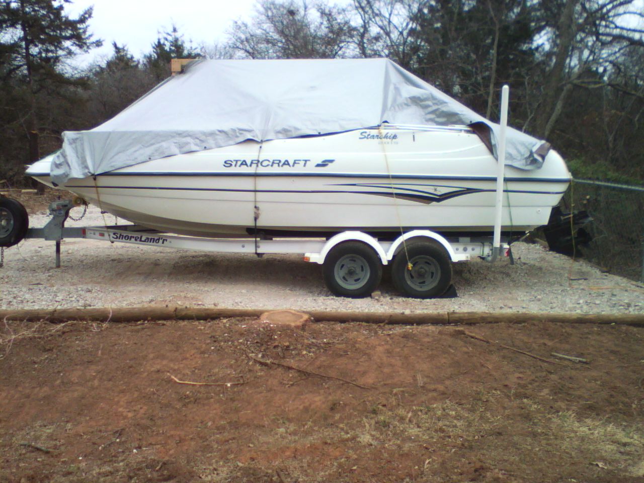

Hi gang, I need to pick your brains. I have been trying to decide what tires to get on our new (to us) boat trailer. This site and other searches get so many conflicting stories and opinions, I thought I might ask you all directly.
What is the best/tuffest, long lasting tire around. The current size is 175/80 13. My trailer is a shorelander tandem, the 13 are the largest I can go with, without messing around with the fenders. My boat is 3250 pounds dry according to
Used 1998 STARCRAFT CO STARSHIP 2015 DB prices, values, specs and options at NADAguides
But this, does not include fuel or anything. I have a feeling that I am right at the limit of these c rated 13's.
Are the Goodyear Marathons good? It seems like just about all tires are made in China now.
Thanks, Dave
