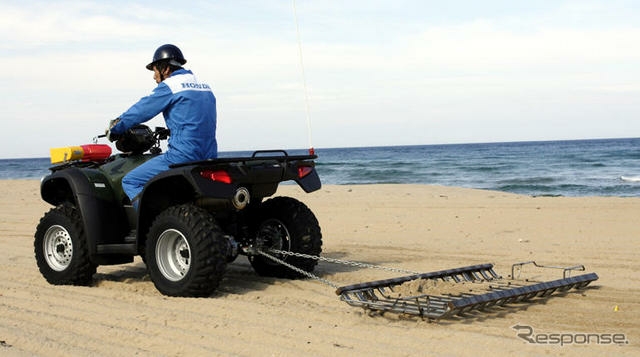

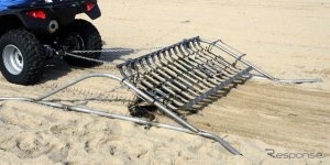

These look homebuilt.
honda begins beach clean project
Honda Worldwide | May 10, 2006 "Honda Begins Beach Clean Project"
Rake:
Rake dumper:
Screen:
