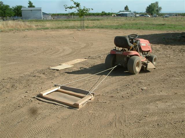

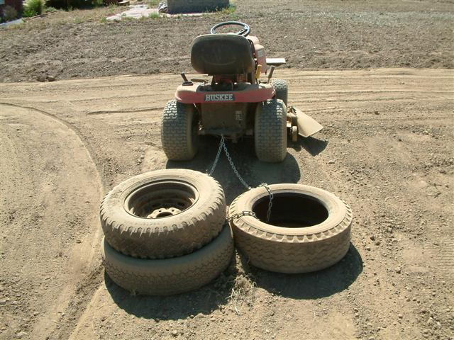

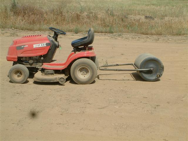

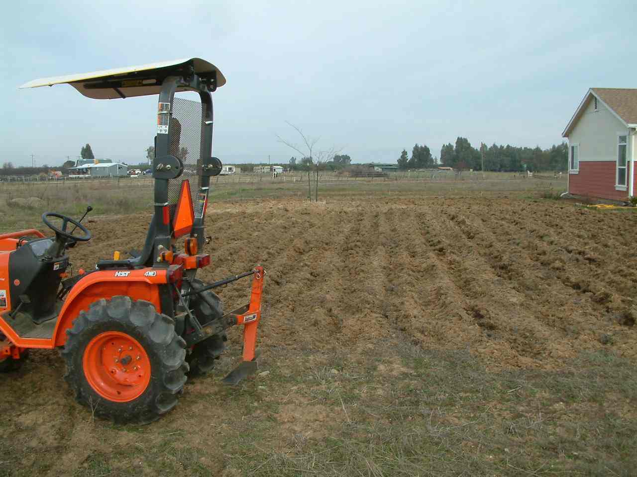

Compaction: get a $150 subsoiler/middlebuster from Tractor Supply to loosen the soil.
Spread topsoil with your TLB--use the FEL bucket to even it out.

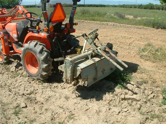

Incorporate the topsoil with a rototiller. With only 1/2 acre, you could do this with a walk behind rototiller. Or find a used rototiller on eBAy or craigslist.
Smooth it out, if necessary, with a simple drag and/or roller towed behind your riding mower.
I used a middle buster behind my 2005 Kubota B7510HST along with a $300 Yanmar RS1200 rototiller (48" wide) that I bought at my local grey market tractor dealer.

Thanks for the help. Flusher - did the rototiller and new top soil take care of the chunks of grass and roots after the middlebuster? or did you have to clean them up?
