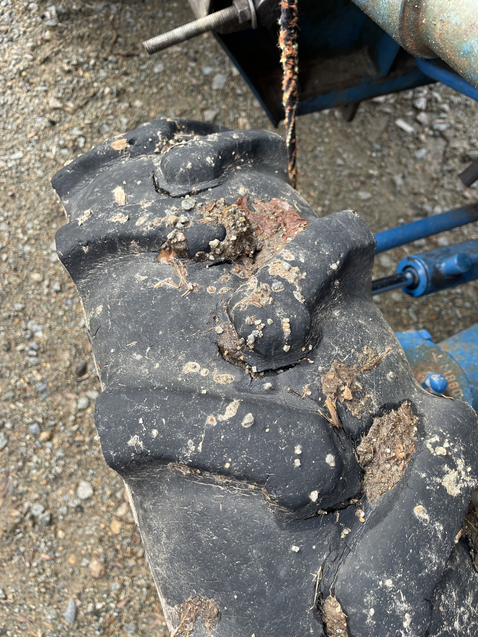

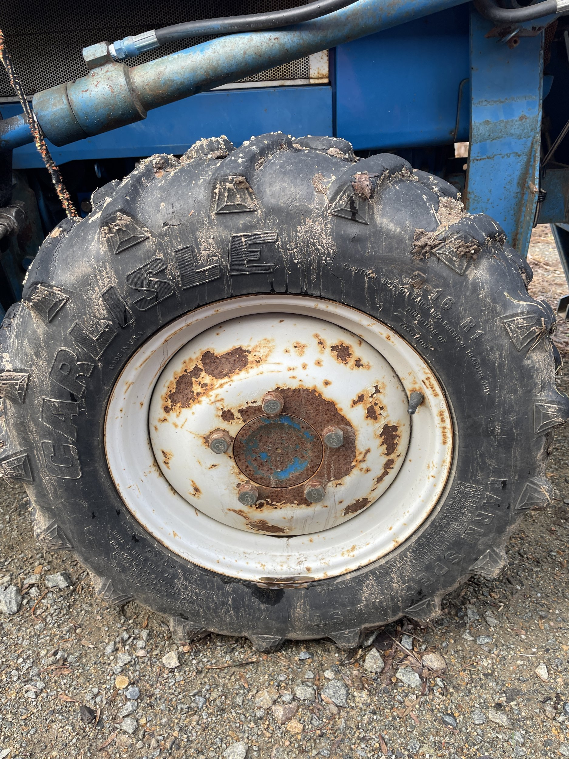

I’ve got a Ford 1720 with R1 tires. We seem to chew through the front tires
pretty quickly because we use the loader a lot. I like the traction of the R1, but wondering if a R4 or R14 will hold up better. Also, would I be able to put a different tire on the same wheel, or would I need new wheels too?

From past articles I've read R4 was the winner for weight carrying ability not sure how they compare to R14 I agree the larger lugs on R1 give the best traction.

An R4 is a lot beefier tire and stands up to loader work a lot better. They’re wider and probably can’t use the same wheels though.

What ply rating are those R1 tires. Going to heavier ply will help with load carrying.

R4 tires will have the highest load carrying capability, but traction sucks on anything other than hard packed surfaces. The factory R2 front tires on my Kubota L5740 would be nearly flattened with a full loader bucket, but I found a 8 ply version of the same factory 6 ply R1 tire, and it has made all the difference. BKT tires. Just make sure it's the 8 ply varient. You get the extra load capacity for loader work, but don't give up that great R1 traction.
