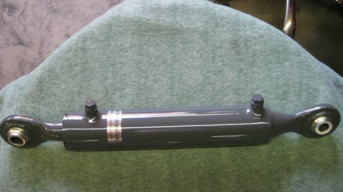

Typically I provide a cat 1-2 top link built with a 2 1/2" dia cylinder with a 1 1/2" dia rod with a working length of 23 1/4"-35 1/4".
This unit seems to work well for my customers with MX tractors.
I agree with that size.
Same as on mine (working lengths), I just upped to a 3" bore.
