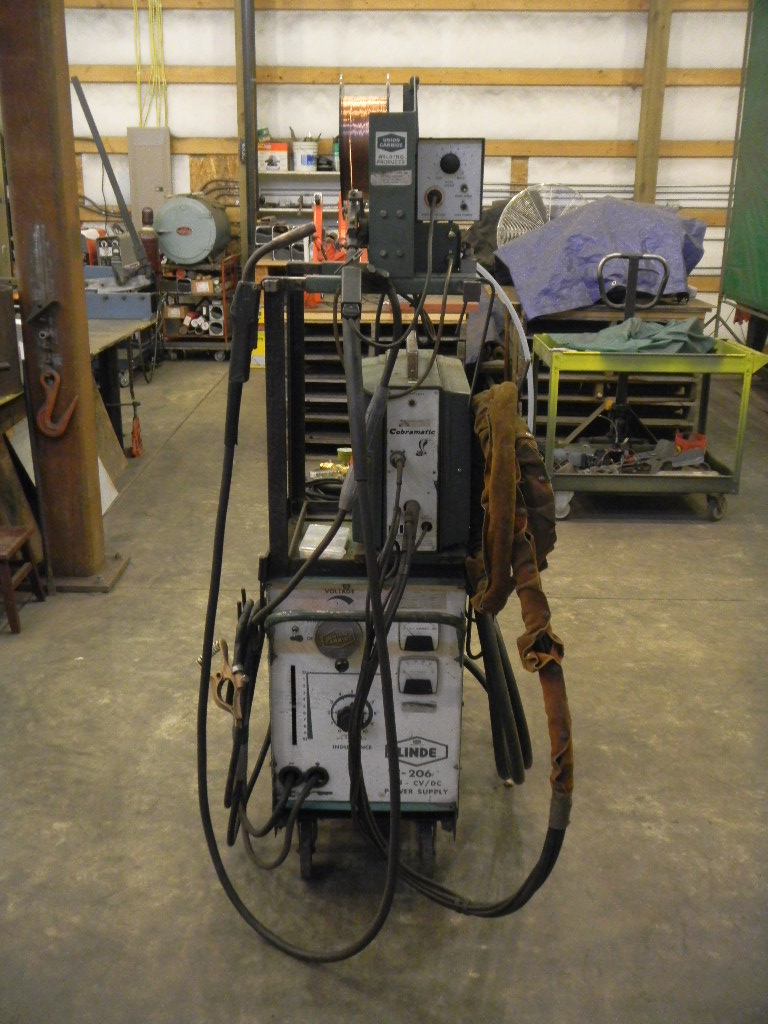

I had a Linde VI-206 Mig machine, with inductance control. In a way you can look at inductance control like arc force. Turn it up, you get a dry / stiff puddle. Which is great for running vertical up hill welding. Turn it down, and you get a wet / flowing puddle. Which is great for welding flat.
