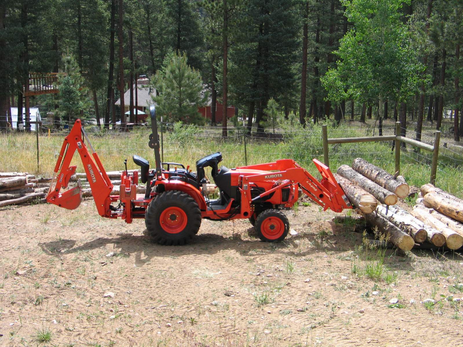

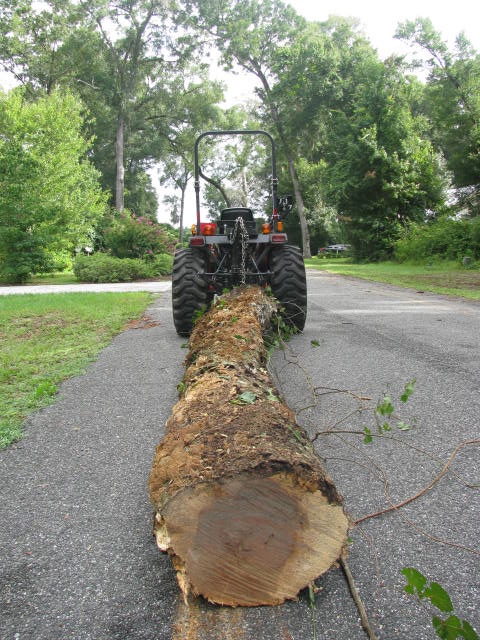

I have owned a B3300SU for eleven months. I have 197 hours on it.
I bought model B3300SU for its maneuverability in the woods and power.
I had the use of a sub-compact JD-750, but 20-horsepower was insufficient for common woods tasks.
If you price out a base model Kabota and add options like FEL, 4-WD, etc., that are standard on the B3300SU, you will find B3300SU combination is a good deal.
I doubt the B3300SU is any more/less of a crawler than other tractors. However, after a year of sitting up there, high, I am much more confident the tractor will stay upright than I was in the beginning. My rear tires are not filled. Filling the rear tires will lower the center-of-gravity but filled tires are a handicap in other ways.
Photo #3 + #4 show aluminum Debris Forks from Payne's Forks plus Ken's Bolt-On (Bucket) Grab Hooks.
Your trailer needs to be as much of a crawler as your tractor. I have a single axle MUTS light logging trailer which gives excellent service. The load is carried low, between the low pressure tires. Other trailer designs have the load carried on a flat bed over the axle, cheaper to manufacture but much less stable.
