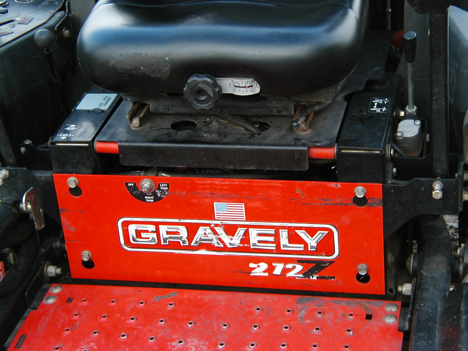

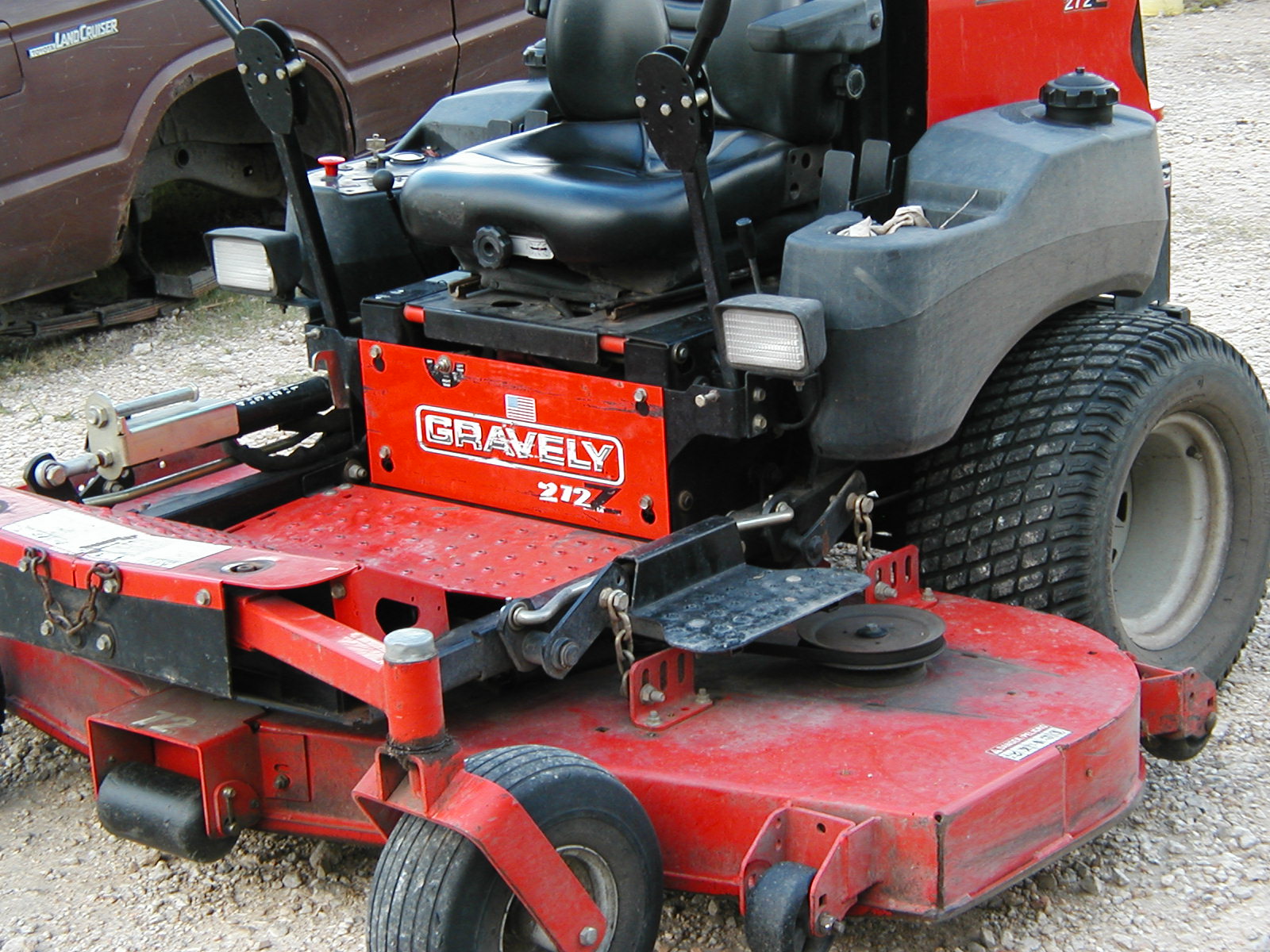

i would check out the big gravely, has good suspension seat, armrests, and lumbar. i bought it used with 840hrs, mows a lot faster than my bx2200 kubota and easy on the back!!! thanks, mark
