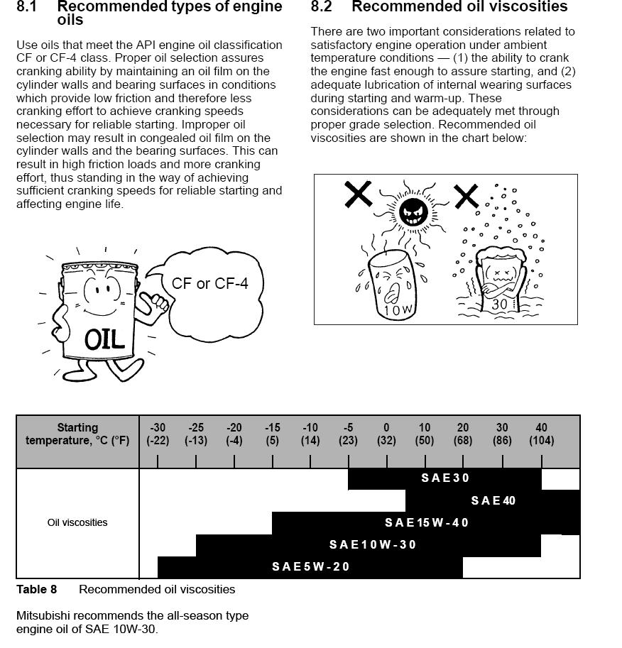

My Montana / LS tractor (Mitsubishi engine) states to use 10/30 Diesel oil; that is what I use. My manual has a temperature chart that you can use to pick the best oil grade depending on you ambient temperature (i.e. Florida vs Canadian temperatures).
This is from the Mitsubishi engine operators manual (not LS or Montana); the graphics pretty much explain it :laughing:
