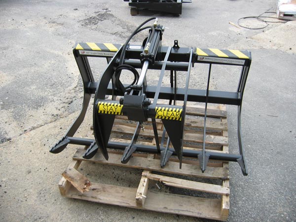

I presume the toolcats have a universal (Bobcat) skid steer mount. If so, why not use a light duty grapple. My 48" Millonzi weighs only 280lbs and though labelled "light duty", it is made of 3/8 inch steel and should be very capable of handling anything you would reasonably do with a toolcat. Cost is much less than for the heavier grapples too. I don't know what they are quoting for them now but you can PM Joe Millonzi here on TBN (joe@millonzi) to get a special TBN quote. I believe Piranha also sells a similar sized unit.
You really don't need more than a 48" grapple if you are handling brush so don't think you need a grapple the same width as your bucket.

Island Tractor,
Did those decals come with your grapple?
Also, what size tractor do you use with the grapple?
-Mike-

Not sure what decals you are referring to. The "safety" decals all came on the grapple.
