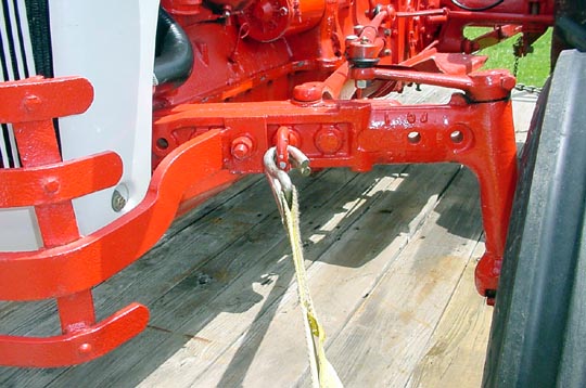

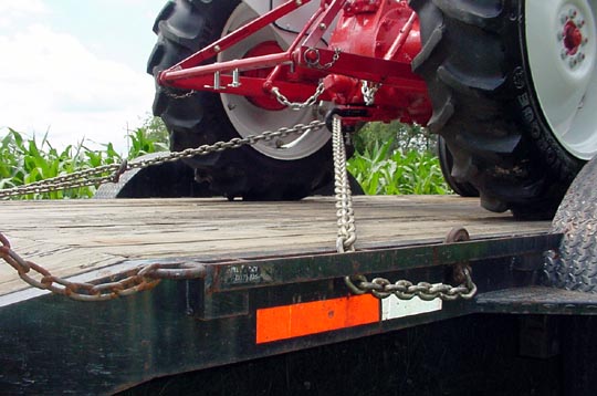

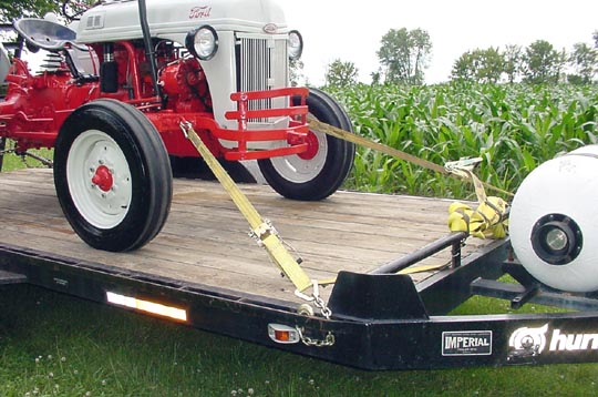

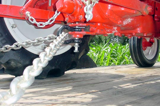

I have used this setup for many years and many miles. Philip.
