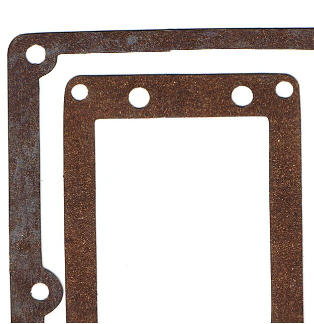

What gaskets are you looking for? On everything but the head gasket I would just make my own.
Chris
   / Best price on Farm Pro/Jinma engine gaskets #3
I agree with Chris. The Chinese cork gaskets are crap. A roll of bulk gasket material from NAPA costs nine bucks. A set of Harbor Freight hollow punches adds $5, and a decent utility knife maybe $2 more. Fifteen bucks and you can make more and better gaskets than the same money can buy from FarmPro.
But the $9 roll limits your max gasket size to 12"x28". If you need a gasket bigger than that, get a pre-formed.

They're everywhere Tommy - here's a shot of the first two I picked up out of my spares box. I believe the larger is a housing gasket, the smaller goes under a cover plate. I pulled a valve cover recently, the gasket was so decomposed that I was able to wipe the most of the remnants off with a rag. In the attached photo, you can clearly see the outer one has enough organic content to support mold.
From my experience that's a cork gasket, pretty much comprised of sawdust and some kind of binder. Don't get me wrong, I've got nothing against GOOD cork gaskets. But those on these tractors are CHEAP cork gaskets, doomed to a (comparatively) short lifespan because of their propensity to absorb moisture

Some already look like that when ya buy'em Dave. What you're seeing in that photo is mold/mildew that's supported by nothing more than normal humidity in an otherwise dry workshop. If not used before, I'd expect the smaller one to start turning green by this time yext year. But that stuff is just cosmetic right now. The REAL decomposition begins after they're actually installed and exposed to the elements. FWIW, I replaced my valve cover gasket the last time I adjusted valve lash on my KM454. It only took a couple hundred hours to turn the previously installed gasket to mush. This time I replaced it with one cut from bulk stock.

Perhaps not being a Jinma owner puts you at a disadvantage Dave. The FarmPro 2420 is a rebadged JM200. Accordingly, it uses Jinma gaskets. See FarmPro Parts - Homier Distributing Company, Inc. and look at their gaskets.
One of these days you'll work your way down to gasket level on your own tractor. At that point, I believe you'll discover that KAMA/TaiShan tractors use the same cheap cork gaskets. I know both of mine do. Even back when I owned Jinmas, I quickly realized that - when replacing Chinese OE cork gaskets - I was better off making them myself. Plus - I don't have to wait for the UPS truck to eventually show up before I can get my tractor put back together. To fair, there are some intricate cuts that might be time consuming, in those cases it might be worth the shipping delay. But so far the longest it's ever taken me to cut and punch a new gasket from bulk stock is 20 minutes (valve cover gasket for my KM454).
If you missed it the first time, I'm not condemning all cork gaskets - just the cheap ones the Chinese put in their tractors and implements, to include their OE replacement gaskets.
