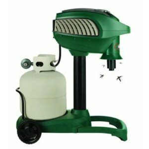

Propane mosquito traps work. They lure mosquitos by producing co2 just like us humans and the bugs are attracted and caught. These units do 1acre and do work. They aren't foggers.
Best Mosquito Trap | Propane Mosquito Trap
