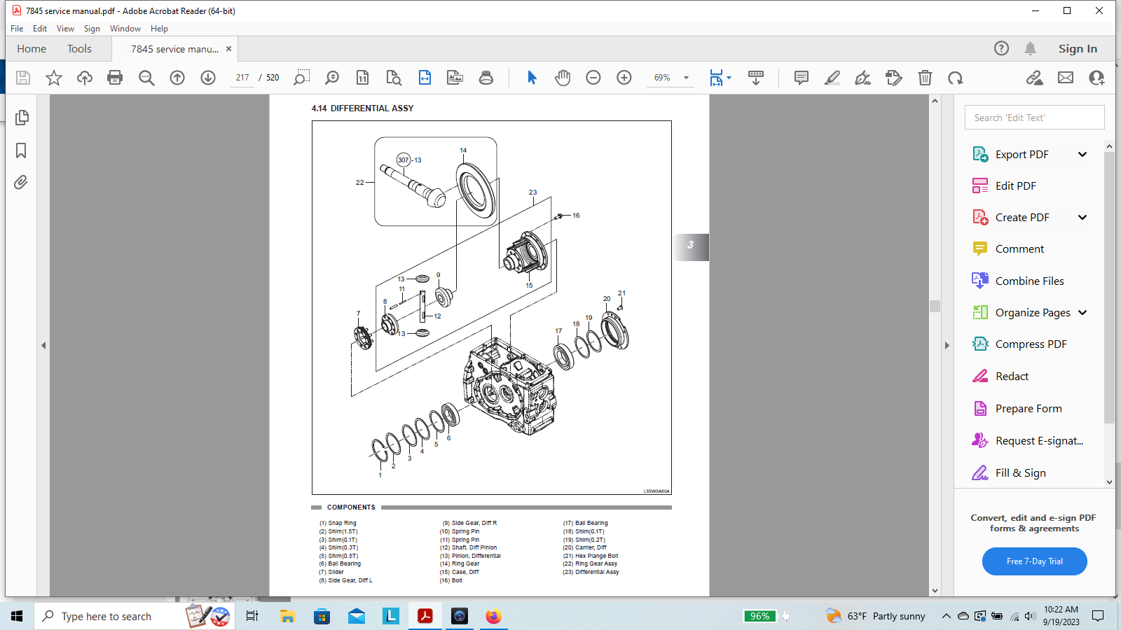

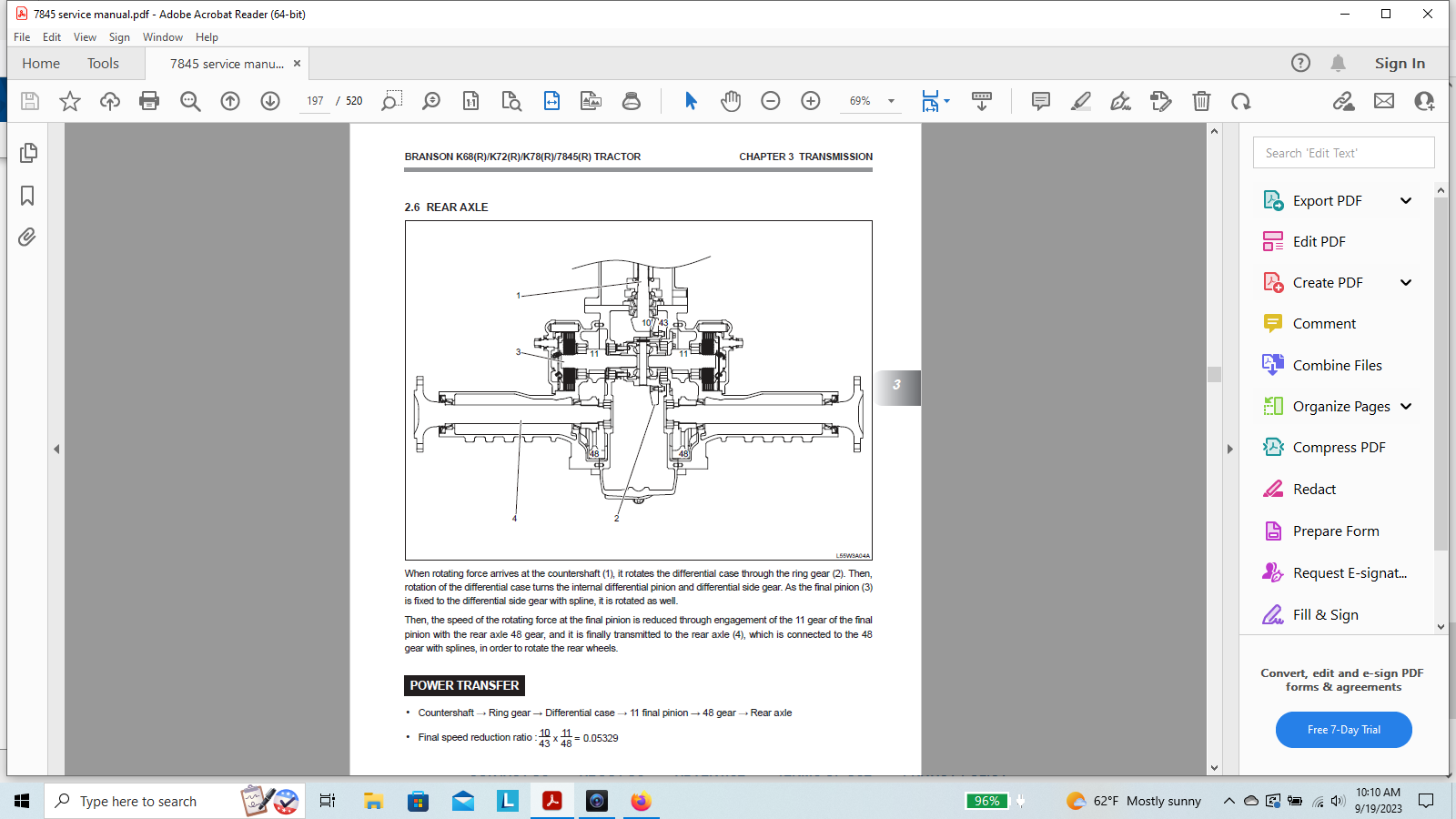

I pulled the trigger on a 2016 Branson 7845R with no rear drive. Front drive works in 4WD. Since you can't normally drive in 4WD without also driving the rears, I figure the only plausible scenario I know of is a busted gear, probably in the differential case. The usual suspects include the pinion gear or a side gear. (Unknown whether diff-lock makes the rear go.)

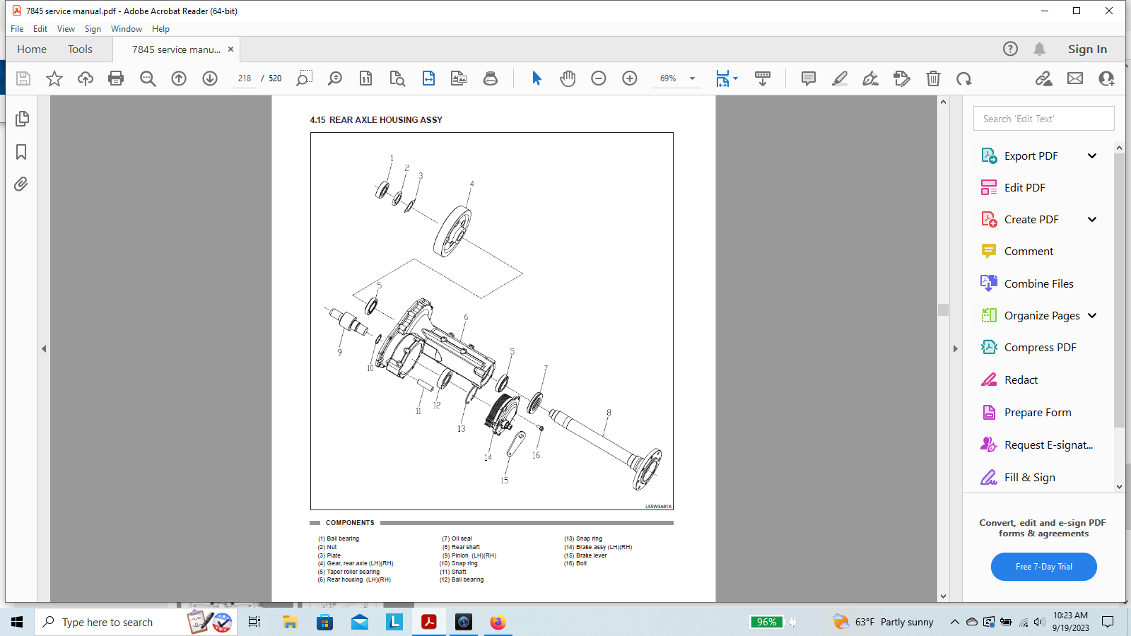

a look at the rear end, best case would likely be drive gear to the bull gear on the axle.

There is a cover on top of the differential case, although I can't find it in the parts manual. Plus, there's other stuff mounted on it and it's under the seat, so there's a lot to dismantle even to get the cover off. The other way to take a quick size-up is to cut open the hydraulic filter. I'll do that when I receive the tractor.

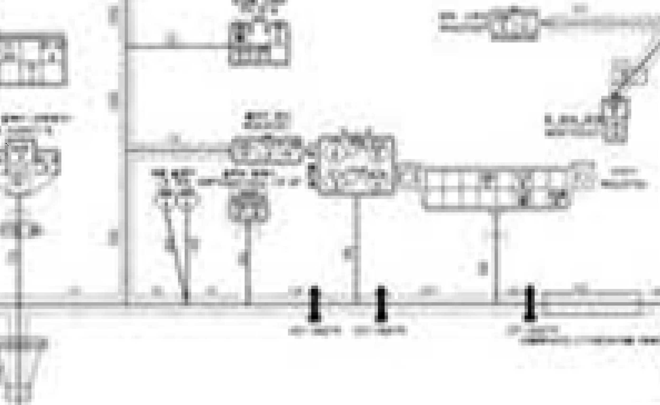

On another topic in the parts manual, how about this wiring schematic? :confused: It's unfortunate that they didn't import the images as line drawings and instead rasterized them with a very coarse and useless resolution.
