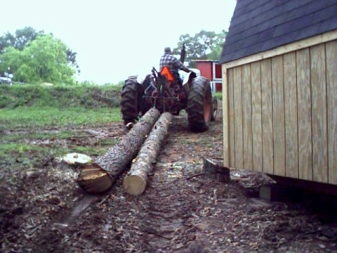

We logged 4 acres of bug pine with a David Brown gas farm tractor with homemade boompole grapple and Zetor with homemade hydraulic grapple. Loaded with case tractor. some were 18 ft. ply-logs. Also the case had an ole homemade winch made from rear end of a truck we used to drag out of the holes. The little David Brown set-up worked real wel. A set of tongs on a short boom pole and drive in dogs for pulling 2 or 3 at a time.

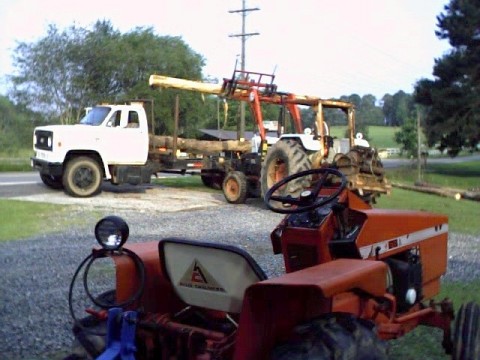

Heres the Zetor and hydraulic grapple. The boom part was made from an ole tube truck bumper.

   / Best setup for dragging logs?? #7
loading on truck

I use a boom pole I paid $69 for. This was a replacement for the 30 year old boom pole that broke when I got a little agressive one day. I use a short chain with slip hooks and pick the logs up just enough to get the leading edge off the ground. Skidding tongs would work better but I've never invested in a set of those.
I've moved some pretty big stuff this way (24"+ dia. x 12+ ft long). /forums/images/graemlins/shocked.gif You do have to be careful because if you overload it and you're on any kind of hill side those logs can take off on you and drag the tractor and you with it ride over the hill. Also watch standing the tractor on end. /forums/images/graemlins/ooo.gif

Thanks for the pics, nice little unit. That's the basic idea I was thinking about minus the grapple ($$) I figure I can draft something up and have a local welder fab it up for me. I'm thinking the upside down L like your unit has but I would put a chain hook at the top where your grapple is fastened on. Then use the 3 PT to get them a few inches off the ground where they attach to the 3 PT. And yes, safety is definately #1. I'm mostly just dragging out wood for burning so can chunk them up into any length I need to, to make it easy and safe.
