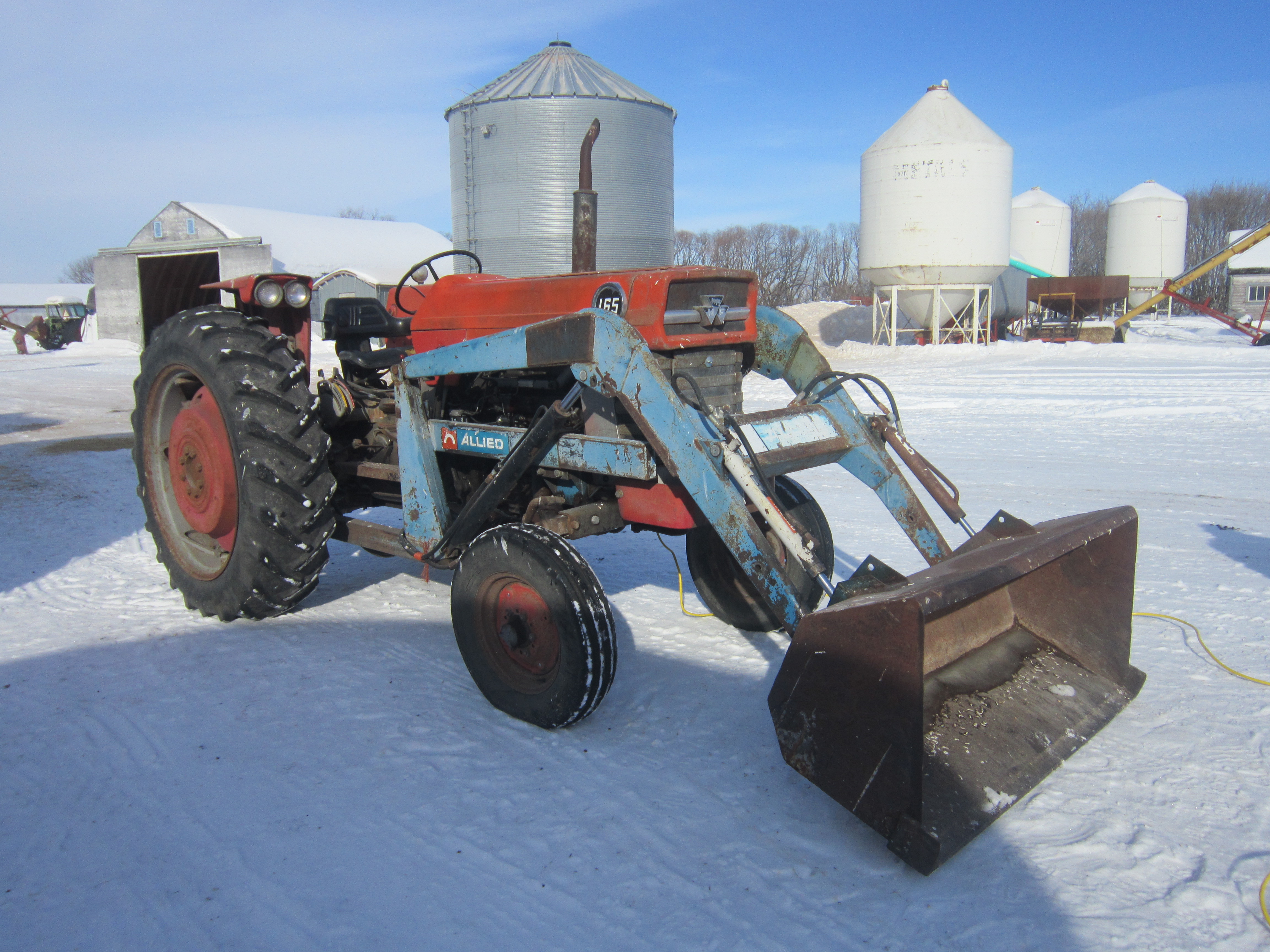

I have an old 165 we use around the yard , Has 15.5 /38's . Seem to look right on the tractor , fill the fenders and sits nice and level . 13.6/36 would probably be more correct for speed etc.
