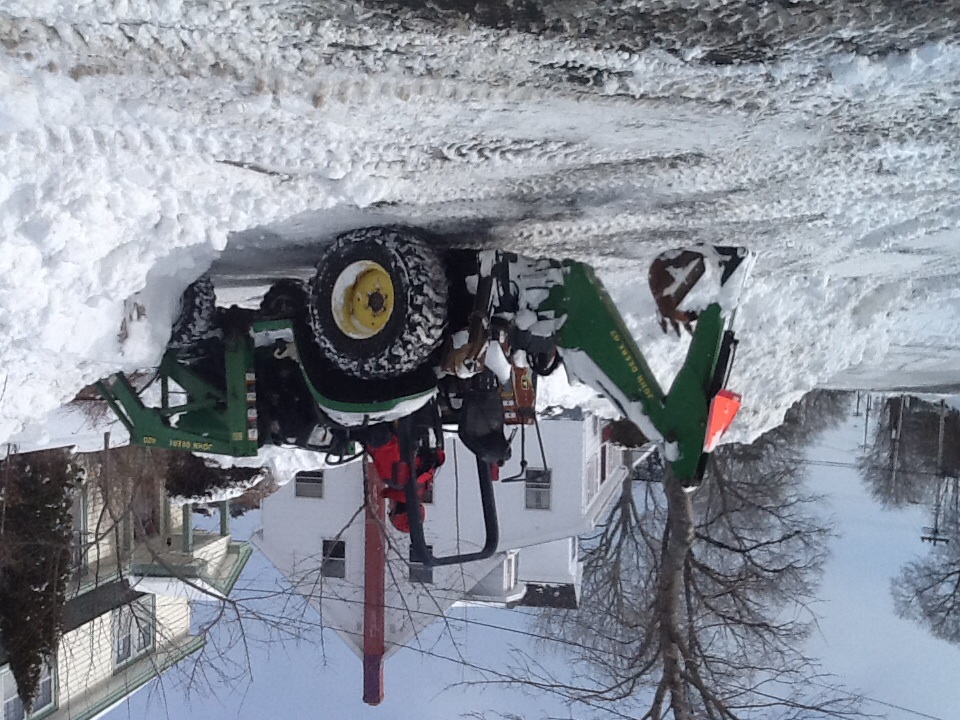

A smaller tractor with factory mounted solid hitch but still let's you remove the backhoe.
My JD 4200 with backhoe fits my needs well.
As usual upside down.
