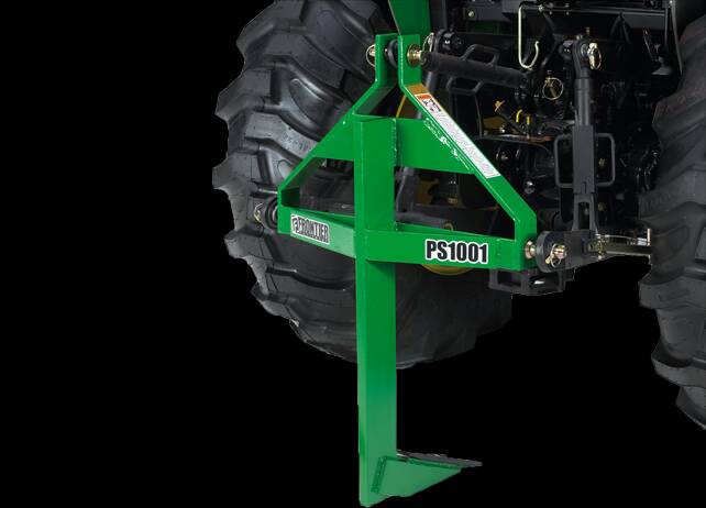

So far I'm leaning towards the green dealer's one like this one. If I can get it for around $300 or so. Like this one...
https://www.tractorhouse.com/listings/farm-equipment/for-sale/28640339/2018-frontier-ps1001View attachment 581616

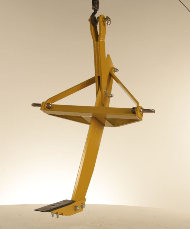

$300 for that one vs. $422 shipped to your home via FedEx Ground for the Everything Attachments Subsoiler(no tax).
With the EA, you get these improved features:
Laser cut A572 steel from our factory here in NC.
Shear pin protection.
A bolted on, replaceable foot. Only the point is replaceable on the frontier.
A larger vertical plate with a > on the front of it so it cuts through the soil better.
A better, point forward, geometry swings forward during transport for clearance and produces desirable results when it hits the dirt.
The Frontier looks more like a potato plow with a subsoiler point. It is virtually a sub $200 piece made by Tarter, painted green, decals added, owners manual tube added and $$ added. No bashing. These are facts.

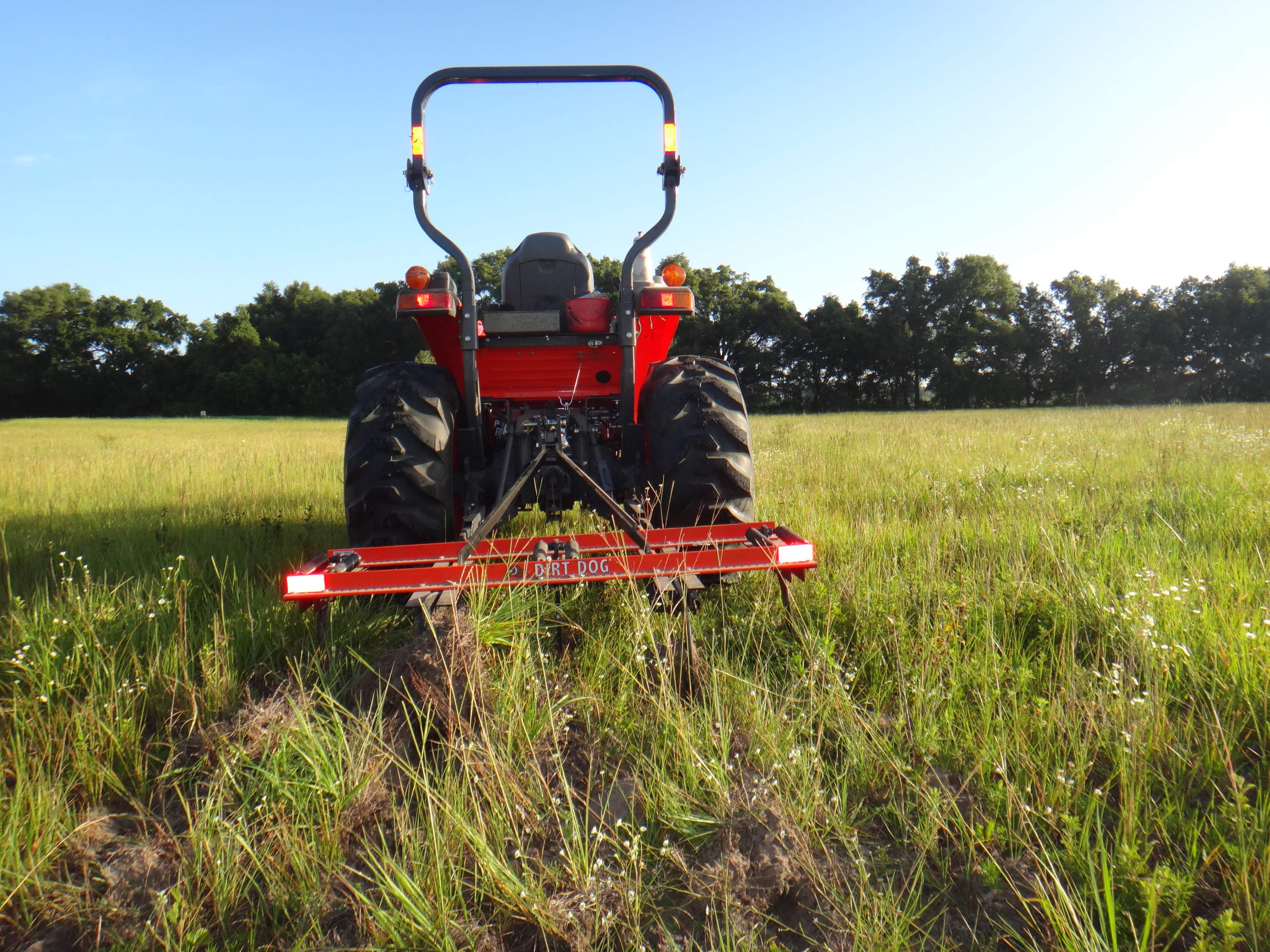

OP has not revealed what uses he plans for a subsoiler. For many tasks a three tine or four tine APP/Field Cultivator may serve better at just slightly increased cost. A three to four tine Field Cultivator has about the same draft force resistance as a single shank Subsoiler pulled 12" deep.
ETA offers Field Cultivators too.
IFE LINK: Iowa Farm Equipment
I am old. I get a kick ordering heavy farm implements over the internet and three days later a sixteen wheeler from NC/KY/IA arrives at the house and delivers same. Selection is so much better than "the old days" and no implement I purchased new via the internet arrived with rust.

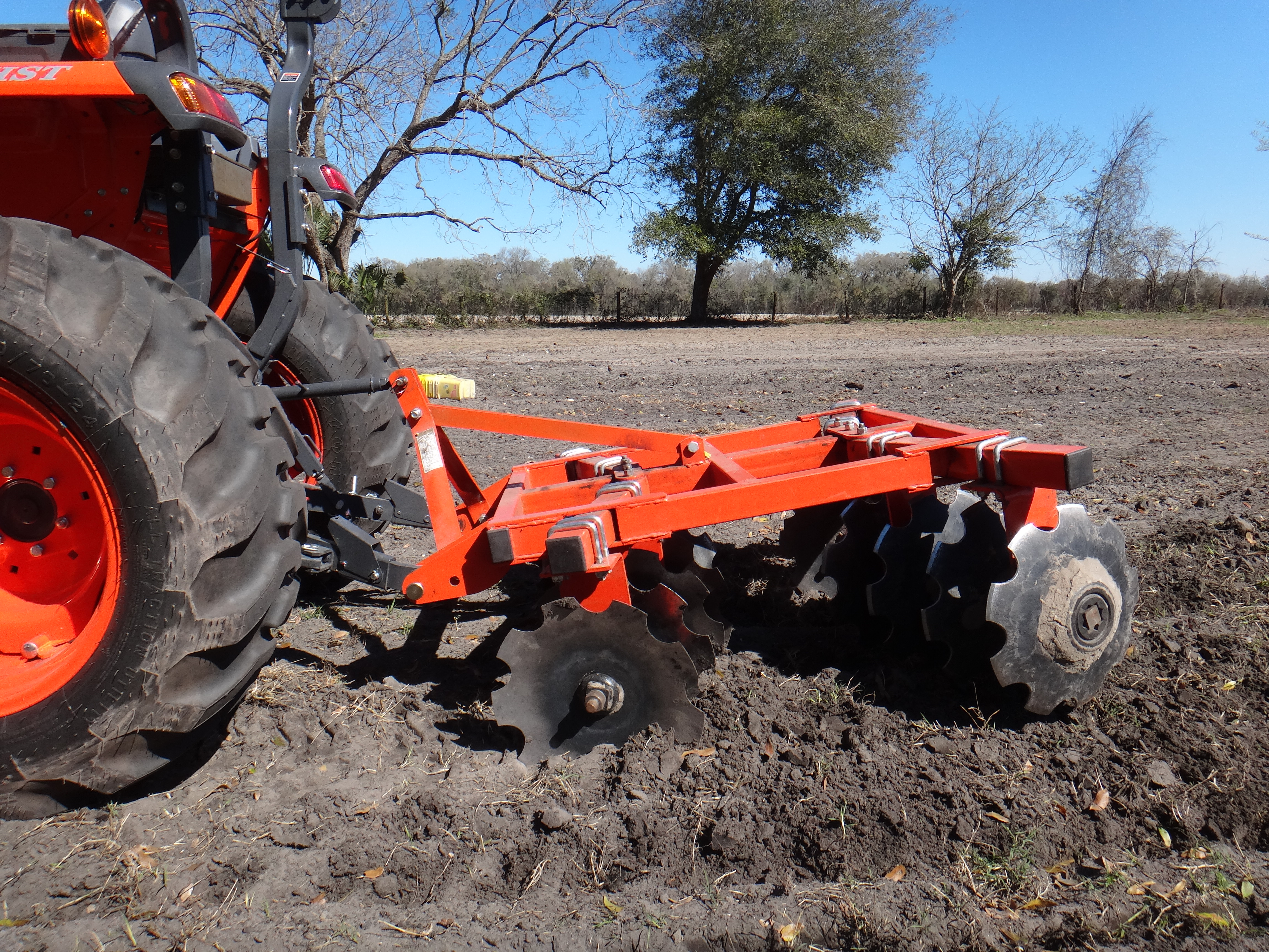

Photos #1 - #2 Dirt Dog APP
Photo #3 Monroe Tufline Disc Harrow, 20" diameter pans.

This is the case with my ETA Subsoiler. Probably the only implement I do not have a photo of. I mount it perhaps three times a year; just often enough to keep it.
The Dirt Dog APP/Field Cultivator is used every week.
