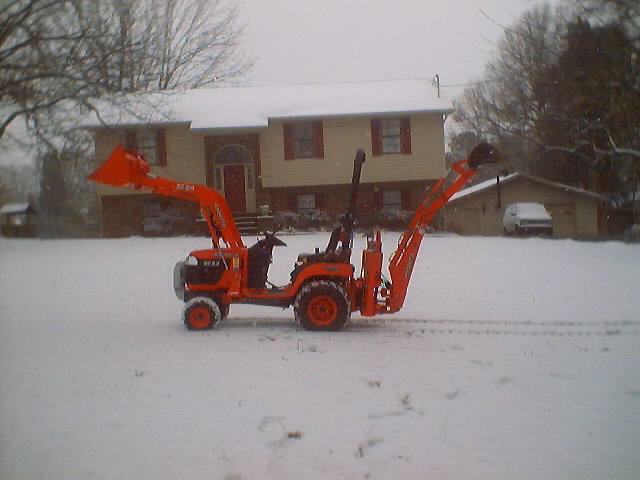

If so, this is now your oppurtunity to really enjoy the process as I did. I went out and tested every contender in the cut & scut class that I could find, and I highly enjoyed it. That helped narrow it down to the scut for me.
All the scuts mentioned are good machines so what you want to do is narrow it down to the machine that fits you best and to a dealer you can strike up a good working relationship with.
After many trips and tests I went with the Kubota BX-23 (the BX-24 was still in development) and haven't looked back since.
It's performed just like I expected it would and in some cases much better. I'm sure owners of the other brands will indicate likewise. Each do the same thing but each are different just enough to give you a different feel.
Go out and talk to the various dealers and try out their wares,
enjoy /forums/images/graemlins/wink.gif /forums/images/graemlins/grin.gif
Volfandt
