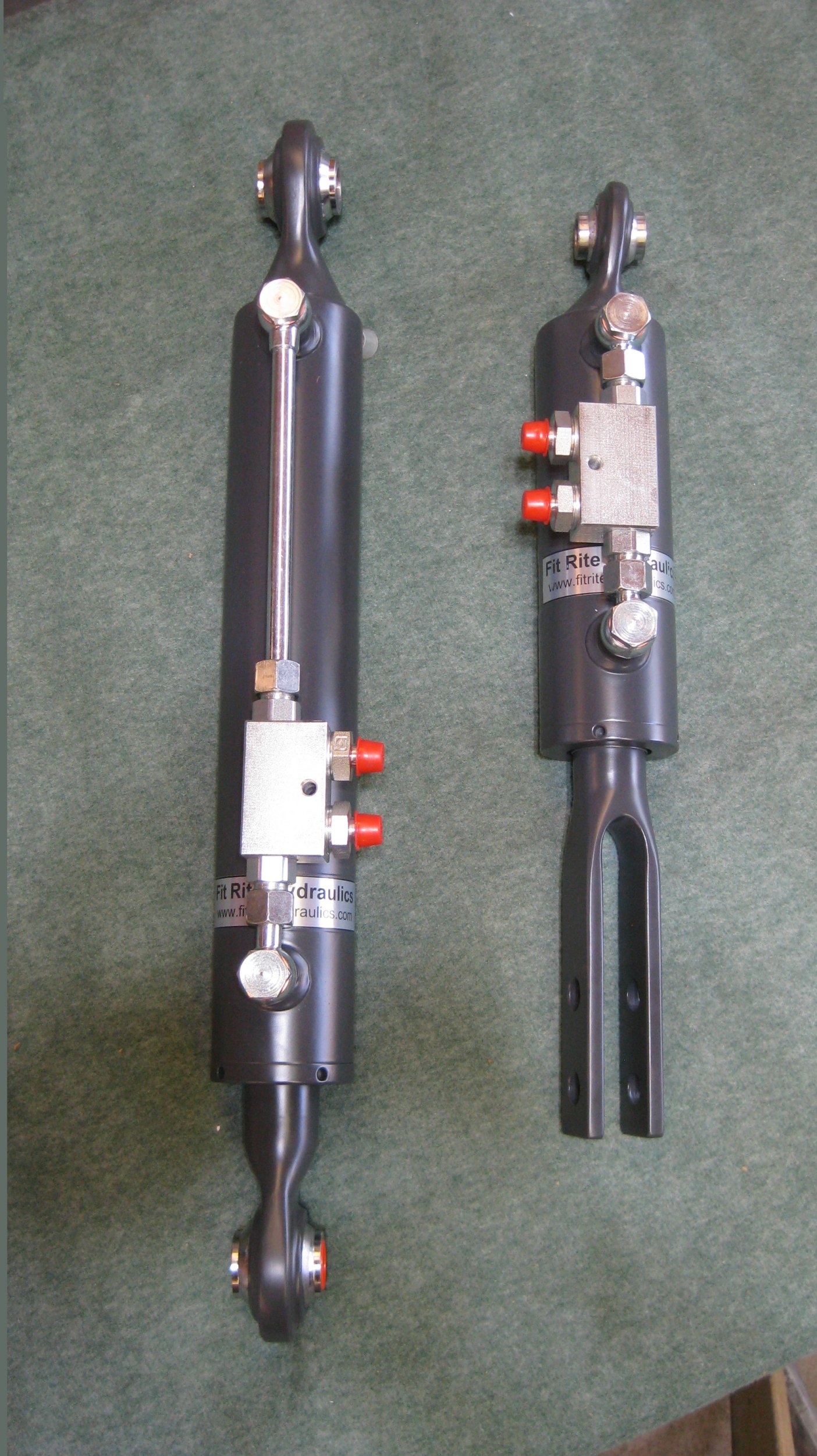

Just bought a new L6060 and was wondering what the best top and tilt kit is? Should I go the Kubota kit or is there a better aftermarket option?

I can't speak about aftermarket.
My dealer installed the Kubota kit as a way of apologizing for the 14 month delay in getting my tractor. It works great, and integrates perfectly.
   / Best top and tilt kit for L6060 #4
I offer 2 different kits for Grand L cat 1-2 tractors.
One set without check valves, one set with check valves.
I doubt that you can find anything any better anywhere.
Fill out the contact page if you are interested.

+1 for fitritehydraulics.com !
It may have changed since I bought my L6060 in 2020 but the Kubota OEM T&T kit was a disaster. There were clearance issues with the cylinder ports. The day the tractor was delivered, I raised the 3pt hitch and it sheared off a fitting on the tilt cylinder. The dealer "fix" was a plumbers nightmare which never worked properly.
I eventually took the kit off and ordered one from Brian at Fit Rite. No problems since.
It's possible Kubota has fixed this issue though.
   / Best top and tilt kit for L6060 #6
I've had a FitRite hydraulic top link for ten years now. It's proven to be a superior product. Not a moments problem. A true homeowner easy install.
BTW - FitRite was recommended by the Kubota dealer OVER the one available from Kubota.
   / Best top and tilt kit for L6060 #7
If me I would order the hoses and hydraulic top and side links with pilot valves from Mt View. See post # 4.
Fit Rite also offers valves. I don’t know if he offers the pilot valves.
Here is a web page with several sources of top link and side link hydraulic valves with and without the pilot valves. I personally prefer valves with the pilot valve.
   / Best top and tilt kit for L6060 #8
My dealer tried & failed 2, maybe 3 times to get one that fit & didn't leak. FitRite fit perfectly. A few years in FitRite developed a pinhole. He promptly replaced it under warranty with no questions. Will get FitRite again if I ever get another machine.
Not cheap & long lead times, but FitRite is worth it.
