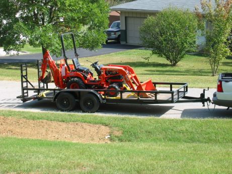

I have a 16' tamdem with brakes on both axles. Dove tail adds 2 feet, ramps fold up. I have pulled this on narrow roads, wide roads and expressway driving. I rides great. Pull it with a Ford Sport Trac with a frame hitch.
