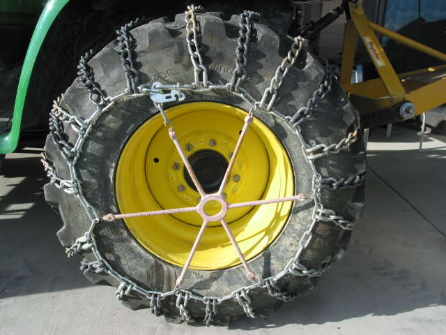

Last year I had a link every 4 loops, this year I took apart a set of new chains that was order for a 2520 I had for 6 months (broke it and JD was taking too long to fix). The extra links gives a better ride and more traction on the R4s. I have a set of v-bar's for front but haven't put 'em on this year. My driveway is .3 miles all uphill and is gravel.
