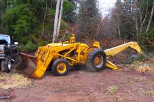

1)Ford 1801 industrial tractor with a backhoe and FEL. says it works, but it's older & slow (does that mean tired??). This one seems biggest and heaviest duty. 4 cycl diesel, selectomatic shifter (whatever that is). No hours indicated, & I assume 2wd.

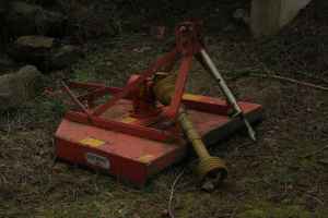

3)89 John Deere 670 4x4, new tires, 3800 hrs, brush hog, and 2-size post hole augger. Good condition, runs strong.** NO FEL. How much to get a FEL to fit this??

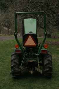

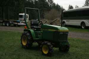

The 670 is a sweet and tough machine...that was my first tractor. But finding a #60 loader may be pretty tough. Also, with 3800 hours, that tough little engine is getting long in the tooth. The good thing is parts are still readily available (except for the loader). But it's also a small tractor with 19 engine HP and 17 at the PTO. I could operate and lift a 60" rotary cutter with no problems, however. But you'd need front weights since there's no loader.
Figure about $3000US for an aftermaket loader.
This machine does have power steering and it's small size might be the best for cleaning stalls, They do well for finish mowing too, BTW.

I saw the 670 and the international on craigslist too. They appear to be in good shape. There is a place in washington with FELs for $1500 or $1700 installed. If i get a loader for my Yanmar, Im getting it there. Ive attached the pictures from those adds on here so we get an idea of what these tractors look like. Ive seen the bolens, it was nice too. The 670 does have a lot of hours but atleast parts are available as the others will be hard to get parts for. Have you looked at any Yanmar tractors? There is a 1300D yanmar with a FEL on craigslist for a good price. It is small but its size will make it easy to manuver around. I also saw a good deal on a 1500 yanmar with a FEL but it was a 2wd. It was in great shape though. I wish you luck with your purchase. Oh, That 670 looks kinda like my Yanmar. :D

I'd steer clear of that Ford industrial. That transmission may be the infamous Ford Select-o-Speed (SOS) tranny that costs a fortune to repair when it breaks.
You'll have better luck finding repair parts for the JD and the IH tractors you're eyeballing.
