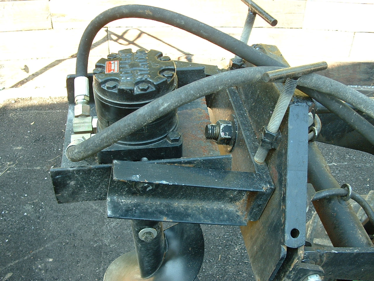

new thread for side topic:
Spare wheel motors, maybe auger head, stump grinder , trencher, saw blade. Maybe give them to your friends , hint, hint.

Send 'em to me. I'll find somethin' to do with 'em.
But seriously, folks - stump grinder, trencher, auger, broom, power rake... low to medium speed, good torque. It mostly depends on what other parts you can scrounge.

Personally, I'd like to make a pot-hole digger out of one, but since I'm not a welder that changes the whole cost-effectiveness equation dramatically if I have to pay someone to create my Rube Goldbergs...
   / best uses of old hyd wheel motors.. #6
Time for you to buy a used Lincoln stick welder. Check out Craigs List. I got mine for $100 (AC and DC). Have a metal shop cut up your template and off you go....
   / best uses of old hyd wheel motors.. #7

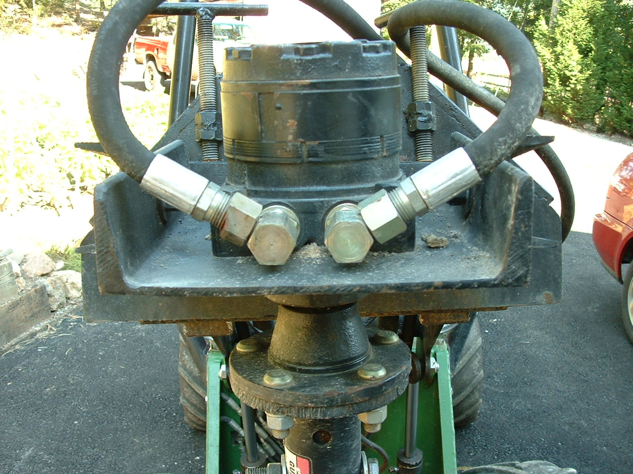

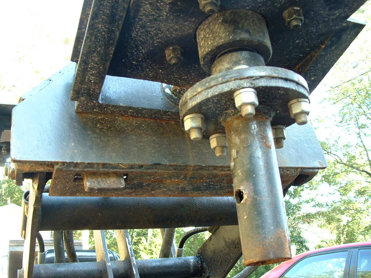

On of the PT guys made this auger setup.
