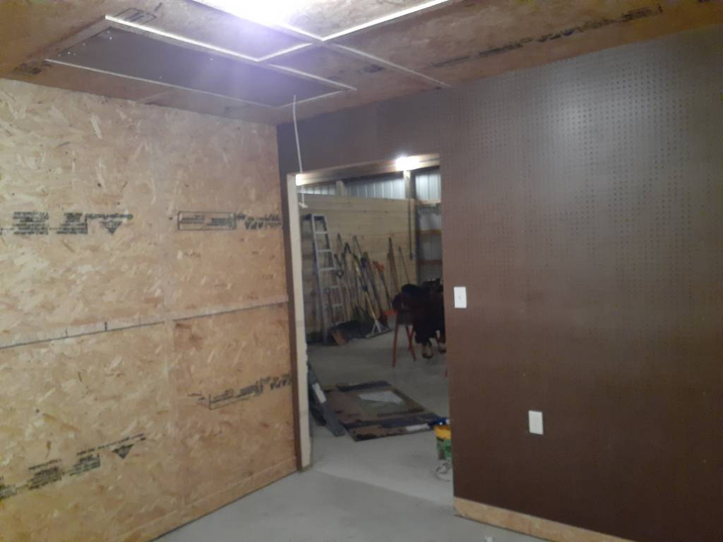

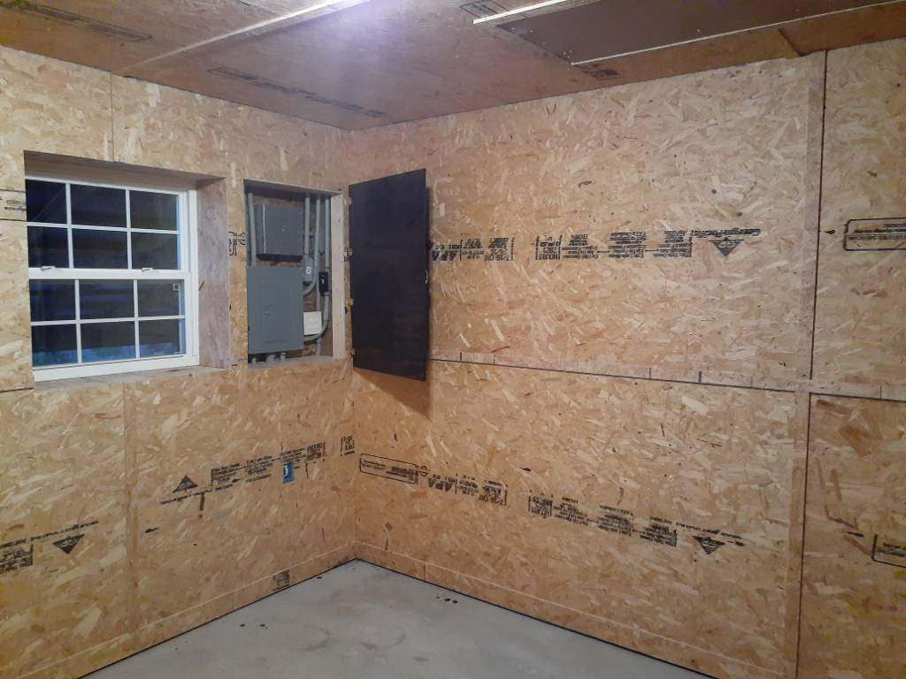

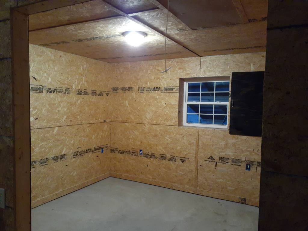

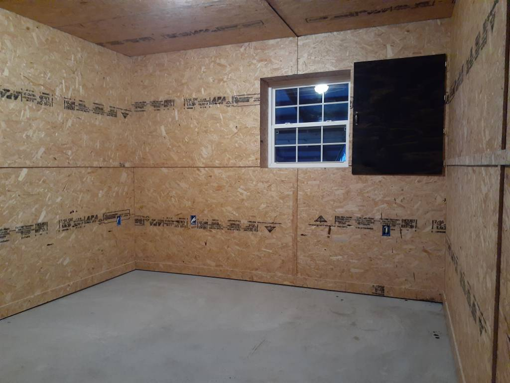

I know there's really good two part paint, but I just finished a 12x12 tack room, and ready to paint, although I still have a 4ft x 7ft insulated door to make.
It's all OSB, floor smooth concrete. I'm looking for best for the money. One wall is pegboard (should I paint also?). Walls R30, Ceiling R38. There are 2x10s behind wall for saddle rack supports. There's a loft which I'll paint also (no walls, just OSB floor).
Ceiling I'm thinking just flat white, no big deal on that. That first probably then walls something pretty durable. Floor most important.
I made a plywood door to cover electric panel, used dark stain I had. Color? (Don't say pink ).

I have never been able to paint OSB where it turned out looking good due to its rough texture so I just left it uncoated in my tackrooms. Plywood is much easier to paint to look nice. White ceiling paint always makes the room brighter even on OSB. Clear concrete floor sealer has been my choice in barns. YMMV.

From the internet: The Engineered Wood Association (known as the APA) acknowledges that you can successfully paint "Exposure 1" OSB.1 Still, their central reservation is that OSB has a thin wax coating that protects it against moisture and inhibits painting. Also, OSB's strands' prominently visible nature will likely show through on one coat of paint, so filler and heavy primer are probably required to remove some of the texture of the wood.

Enamel is probably the best choice if you aren’t going to use an epoxy product. Yes OSB can be painted to look ok, but it usually requires multiple coats, and using a primer first makes this much easier.

Definitely use a good primer. I like Kilz Mold & Mildew Int/Ext Primer, would especially help with the black lettering. As far as saddle racks we went with freestanding. Easy to move out to clean. The Western saddles go on the bottom and English on the top 2.
