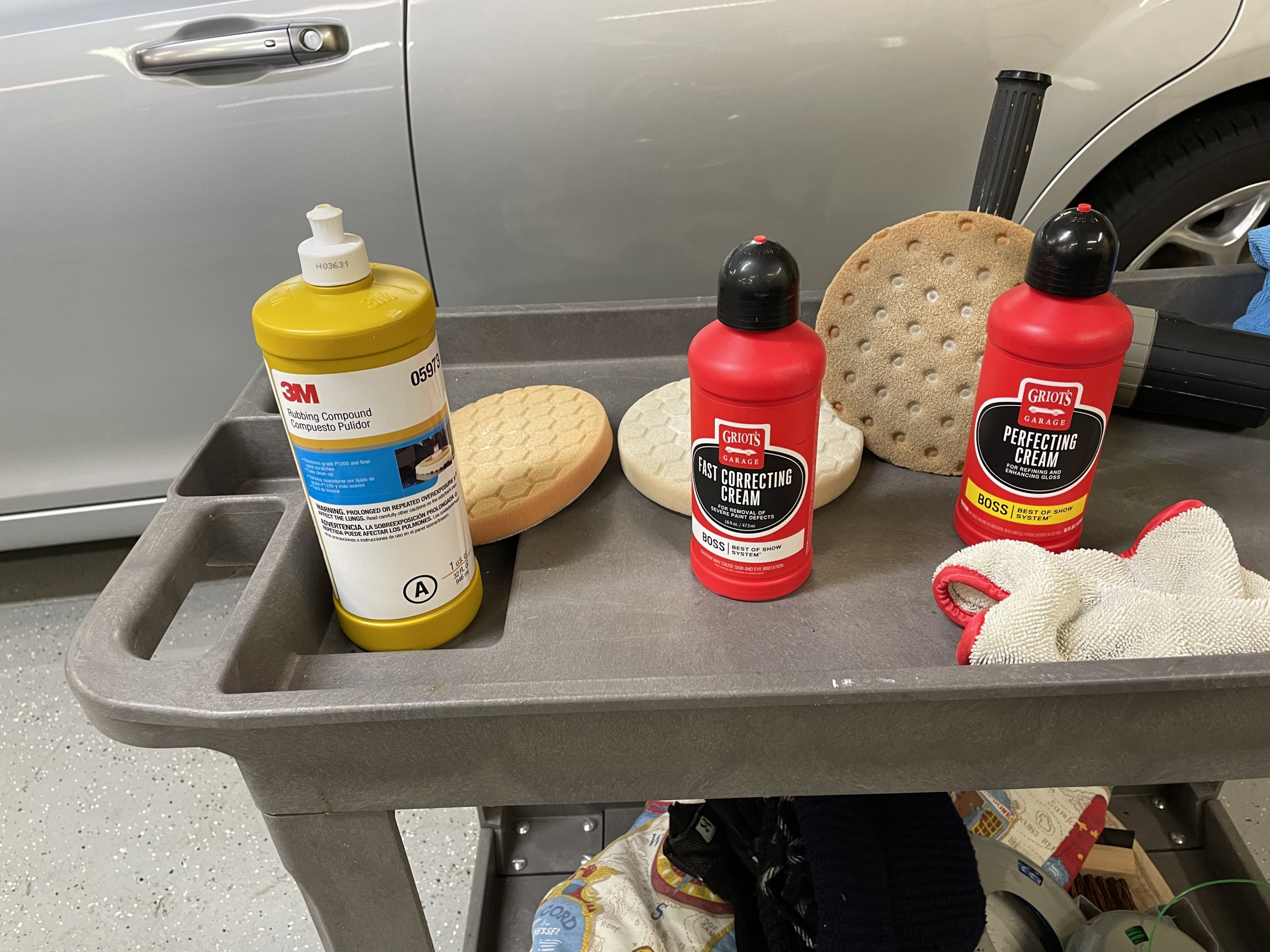

I use a Porter Cable random orbital buffer. The pic show the compounds I use, the most aggressive on the left and least on the right. You can also control the cut with how firm or soft a pad they use. People are often afraid to use a power buffer because they’ll cut the paint off. It is possible but you’d almost have to try and do it. You just have to dig in and try it. You can improve a vehicle a lot just by a power buffer and a good synthetic wax.

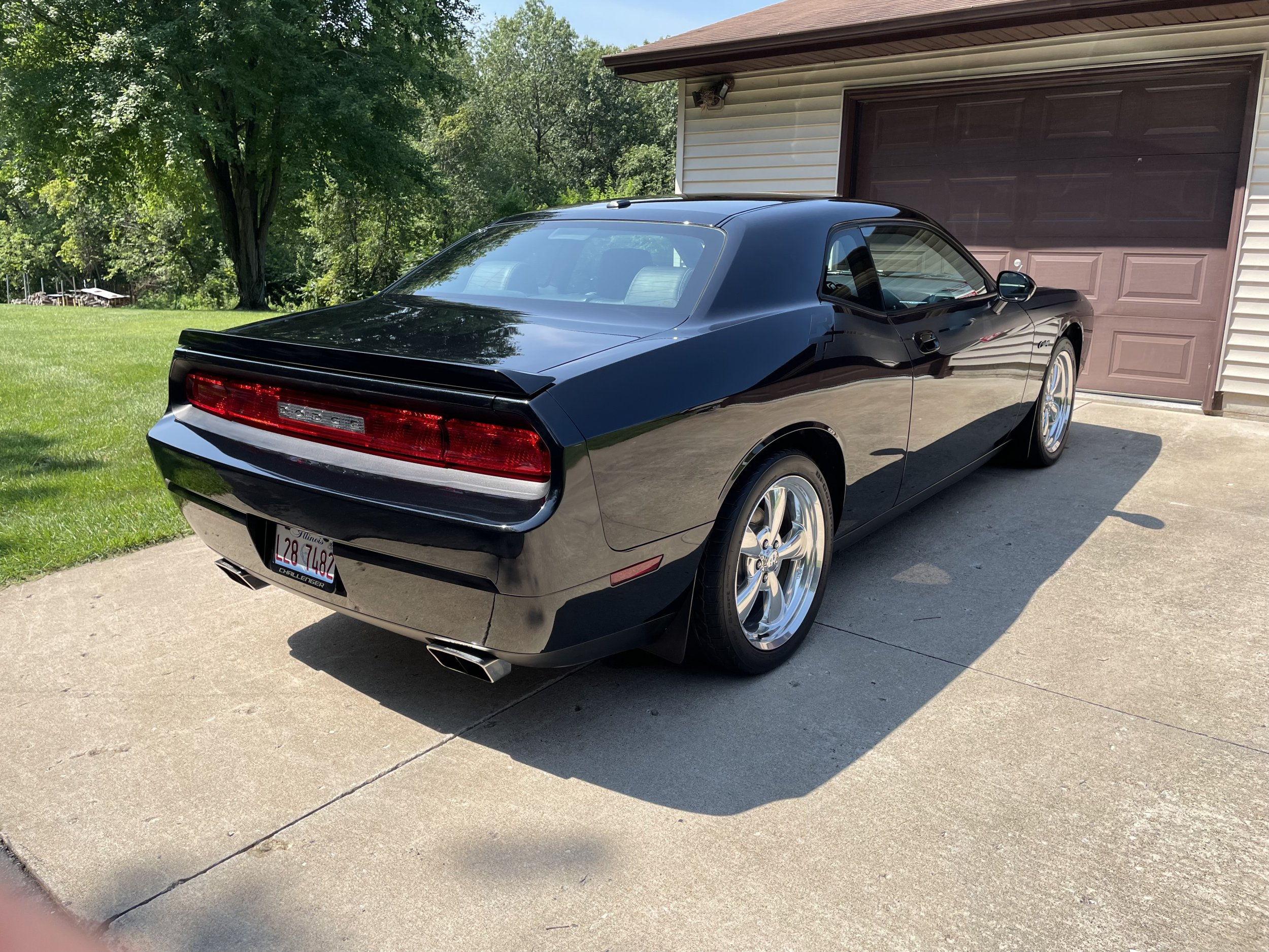

The results on a black vehicle, although it’s a 2010 but low mileage and I’ve had very few scratches to remove. You can get results without the power buffer, it’s just a lot of work.
You're right. I buffed cars for years and you really do have to go out of your way to burn through the paint---provided it hasn't been buffed a million times or heavily wet sanded.
I agree using a good quality buffer and high quality compounds will generally fix up most blemishes.

Use a RANDOM ORBITAL buffer. It is way less likely to do damage than a rotary buffer.
