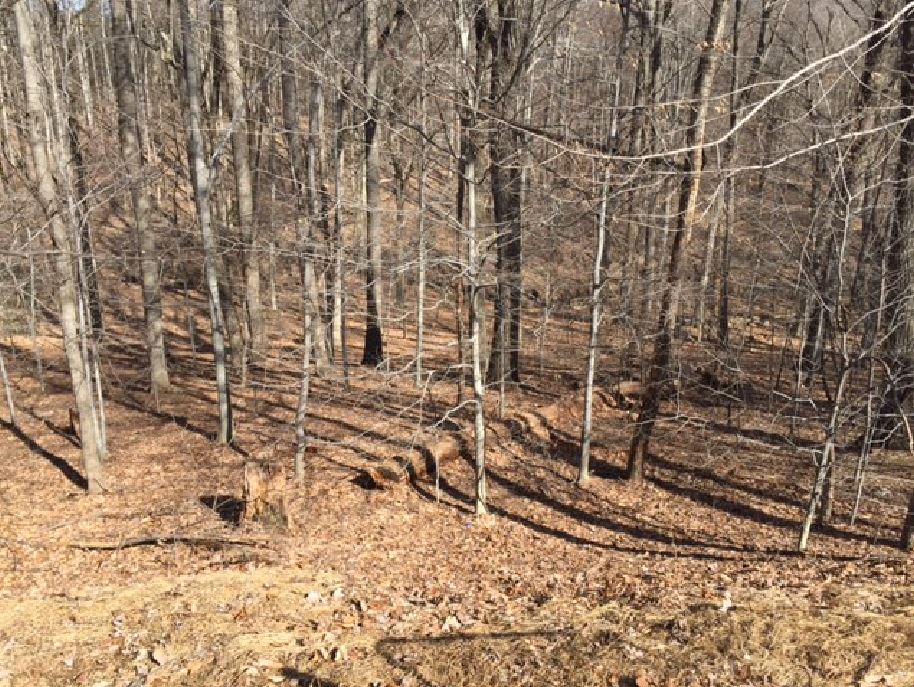

The first major project of the spring is going to be to clear out a ~1 acre section of woods to the side of my house of all of the 2-4" saplings so that the big trees have a little more breathing space. When spring comes, you can't even see through the woods, and I'd like to thin it out. I also need some wood chips, so I plan to run them through my chipper to use for a couple of pathways and landscaping areas, so I don't want to just push them down with the FEL (which is what I did on a different section of our land.)
I'm thinking of a couple of options and woud like your opinion for what would be easiest for a one-man show (like most of my projects, this one will be a solo gig.)
1) Cut them with a chainsaw just above the ground and leave the stumps to rot
2) Pull them out of the ground with the tractor, then cut off the root balls before I chip them
3) Cut them off about 3' above the ground, chip the tree, and then pull the rest out of the ground using the 3' leftover stump for leverage whenever I can get to it
4) (Least desirable) Run through them with the Piranha tooth bar on the FEL and then clean them up of any extra dirt and debris before I run them through the chipper (seems like extra work to me.)
I know 4 would be fastest for the "clearing" part, but since I'm going to chip them up, I don't want to dull the blades with unnecessary dirt and debris. Right now, I'm thinking that #3 might make the most sense. Cut them and chip them the first day, then come back the next day to pull / tear out the rest with tractor.
Any suggestions?

I can't tell from your photo -- what species are the saplings?
Depending on the species, you may get sprouting from the stumps if you go with option 1. You can treat the cut stumps with glyphosate to prevent sprouting.

Thanks guys -- I was thinking the same thing, but was worried about the stumps sprouting again. They are a mix of Oak and Beech, but there's a maple or two in there as well. We have some AWESOME old-growth beech trees in the forest (some 4-5' across at the base), and that's part of why I want to clear things out -- to give these old girls some breathing room so they thrive for another 50 years.
The wife is a BIG negative on the glyphosate, unfortunately. She's totally organic and believes all things Monsanto are evil. I actually agree, but may try to sneak in a shot of glyphosate anyway. Maybe if I buy the generic brand from Tractor Supply instead of RoundUp, she won't notice...

That woods doesn't look too thick to me, so just keep in mind that a healthy forest should have multiple generations of trees before you take out *all* the saplings. Thinning some is OK. Also be careful about impact to the trees you want to keep when operating in/around them, in terms of driving over roots/stems, soil compaction, and dings to bark/etc. It's easy to do more harm than good to your intended keeper trees if you're not careful, but a 2320 should help minimize things compared to a large tractor.
When I had to clear a path through saplings, my approach was to cut them off with about 18" of stump remaining, and use a brush grubber on the end of a chain to flick the stump out of the ground cleanly (most times it would barely even leave a hole). I'd toss the stumps/roots to one side of the trail, and the trees/tops to the other, then come back later and chip the trees/tops in place as I worked back down the trail. If you want to used the chips for other projects, then you may need to drag the trees to a common location where the chip pile will be, so it's a little less convenient. But if you can pull a wagon along to catch chips, that works well.
I don't think your #1 approach is a good idea, as the trees will most likely sprout suckers and grow back, then be unhealthy eyesores and a net negative impact to the forest. The #2 approach will require a lot of working space which you probably won't have once you're in the woods.
