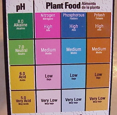

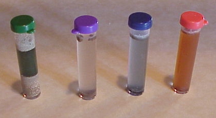

If you have access to manure from horses, chickens or cattle etc. do a little experiment on a portion of your garden area by applying it heavy in the fall and tilling it in to decompose over the winter. I add vegetable and fruit peelings etc. all year by shallow trenching and bury method.
Soil test - kits with instructions are available for cheap and you can do the testing yourself. The test in the jar is for soil structure and when you do it your county extension can probably help read it. Humus content seems to be important to master gardeners.
