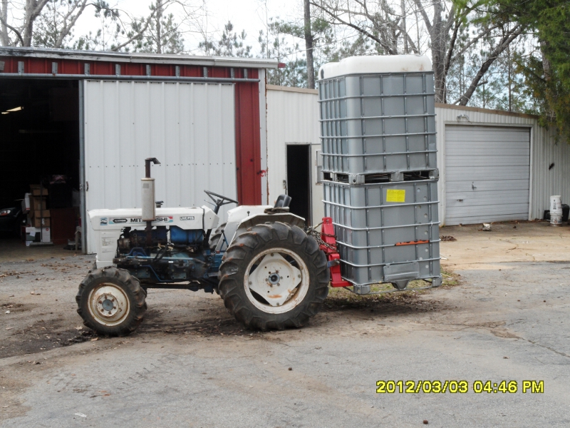

I've seen guys driving around with an IBC tote full of amber liquid near the gas station. Looked like they just filled it up. A 275 gallon tote would weigh about 2,200 lbs so you need a decent truck or a trailer.
When I finally get moved down here, or the next time fuel prices nosedive, I'm planning on taking one of my IBC totes to fill it up.
