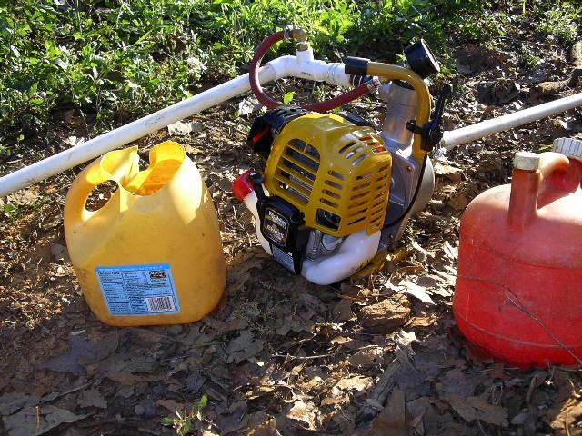

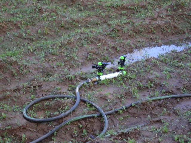

100x100 pretty big. It will take some time to water. Drip is nice but it sounds like you don't have power there(the gas pump). I bought a little Robin 4 stroke water pump off ebay and used it last year. Sweet little motor and pump. 1" intake and I ran it out 3/4" pipe. It didn't have to lift that much because I left it close to the pond, but ran about 150' of 3/4" pvc then a 100' hose or 2. put 2 sprinklers together for max watering. I was pushing the water up about a 5' bank. With the throttle I could adjust the pressure(I put on a gauge). The pump runs on regular gas and runs about 1 hour at full load. So I could watch my watch and reset it. TIn the pic the gas can is 1 gallon. The thing weighs about 12#. Easy to start and run good.
I doubt if I'll ever use the pump again (going to let God take care of the watering) so if you are interested I might make you a deal.

pic 2

Go with 3/4 impact sprinklers spaced out with 50% overlap. Puts out lots of water to keep pump runtime down. Less filtering required for impact sprinklers due to larger nozzle size.
